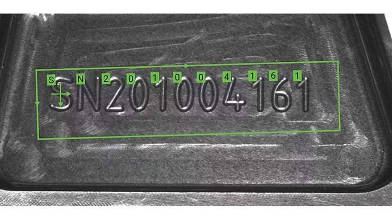

optical character recognition on DPM codes
Edge-learning vision systems can quickly perform optical character recognition on DPM codes, even in low-contrast conditions or when a code has sustained damage.
Source: Cognex Corp.

For some applications, it’s worth testing both edge and deep learning. Traditional optical character reading (OCR) algorithms struggle with reading vehicle identification numbers (VINs) and direct part marks (DPMs). Depending on the method of direct part marking, the lighting conditions, the material being inspected, and other variables, edge learning can address OCR and DPM reading with a handful of images. However, deep learning would be more effective if there are complex textures and backgrounds, inconsistent illumination, and nonuniform, poorly marked components.
