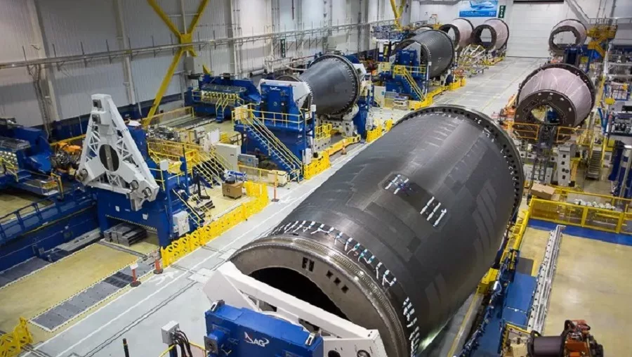

Aft barrel fuselage sections for Boeing 787s from Boeing's Charleston, S.C., facility on March 25, 2018. Photo courtesy Jeremy Dwyer-Lindgren.
