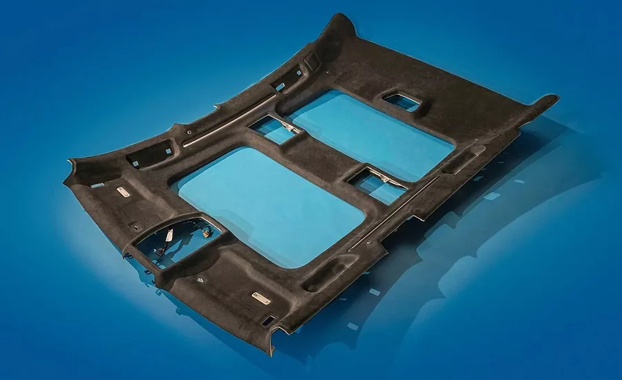

The assembly of headliners is a complex manual process with more than 30 steps, and each car model has significant variation. One car model has 20 to 30 variations alone.
“This was not a particular commodity that anyone within our factory had experience building. So we had to learn ourselves, and then train new operators on the task,” explains Maurice Stallard, director of engineering and manufacturing for HJI.
The headliner assembly process also requires careful instructions and time specifications. For example: “Apply sealant and hold down for 10 seconds to let the glue set correctly.” Mistakes are easy to make without automated error-proofing built into the process.
