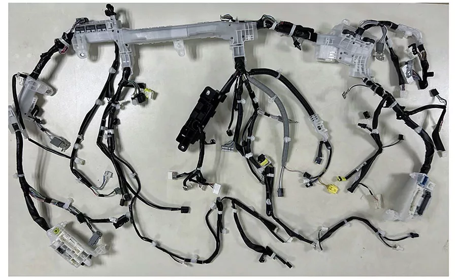

Automotive wire harnesses contain myriad components, including connectors, relays, sensors and even small controllers.
Photo courtesy Guangzhou Industrial Intelligence Research Institute
July 25, 2024
Automotive wire harnesses contain a variety of components, including connectors, relays, sensors and even small controllers. Inspecting them is a challenge. For example, relays for different models often share identical dimensions and can be installed in the same location. Attention to detail is critical, and the risk of errors is high.
