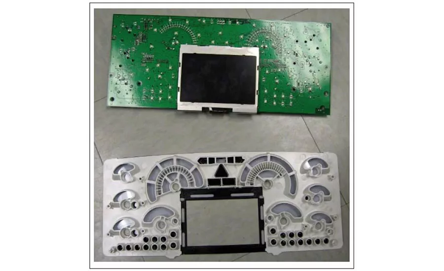

I once worked on a project to develop a new vehicle instrument cluster, as well as the cluster’s assembly line. During the PFMEA, one of the failure modes that was uncovered and prioritized was the bubbling of the overlay due to repeated heat on the light guide. This bubbling would ultimately impede the movement of the pointer. A pressure-sensitive adhesive was used to bond the overlay to the light guide. A press applied even pressure to ensure the overlay bonded to the light guide.
The PFMEA evoked the possibility of bubbling. To assess this perceived failure mode, the assembly was subjected to long-term thermal cycling as part of the PVT. At the end of the test, an evaluation was performed, and we found that adhesion of the overlay to the light guide was, indeed, compromised. Subsequently, the overlay process was changed to include a weighted wheel rolled over the overlay, ensuring a better adhesion to the light guide.
As a recap, the pre-launch control plan described the actions to affix the overlay to the light guide on the assembly line. The line produced assemblies at the expected rate, which were then used for PVT. Analysis of the assemblies indicated that the manufacturing process was not likely to produce the desired results. The control plan, work instructions, and tools for this process step were altered to remove the failure mode.
