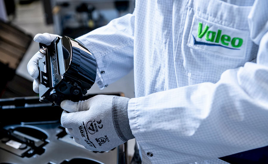

LiDAR sensor
Lidar sensors play an important role in advanced driver assistance systems. Photo courtesy Valeo
