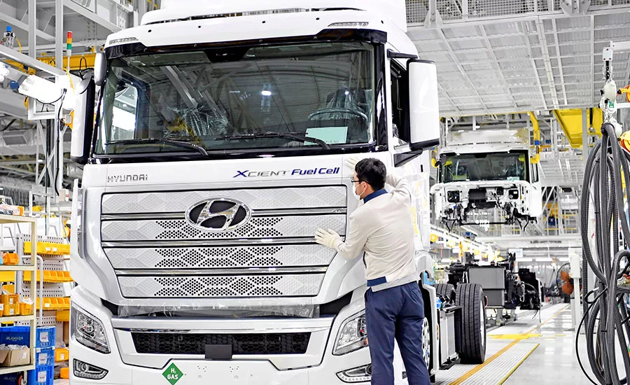

Xcient heavy-duty hydrogen-electric truck
The Xcient is the world’s first mass-produced heavy-duty hydrogen-electric truck.
Photo courtesy Hyundai Motor Co.

Hyundai is a major player in HFCV development, with a growing portfolio of hydrogen-powered vehicles, including the Nexo SUV and the Xcient Class 8 semi-truck.
According to Gregeois, a light-duty HFCV can refuel in just three to four minutes, while the company’s Xcient trucks achieve full refueling in 20 to 30 minutes. The goal is to reduce that to under 10 minutes.
Hyundai’s commercial vehicles, including Xcient trucks and hydrogen-powered buses, are manufactured in a dedicated facility in South Korea. The assembly process for hydrogen vehicles mirrors that of ICE vehicles in many ways.
The fuel cell stack, which occupies a space comparable to a four-cylinder or V6 engine, is installed in the engine compartment. Hydrogen storage tanks are positioned where gasoline tanks would traditionally be located, with pipes connecting the tanks to the fuel cell stack.
While BEVs typically require fewer assembly processes, due to the absence of complex air processing systems, HFCV architectures ensure a seamless transition for manufacturers familiar with ICE vehicle production.
