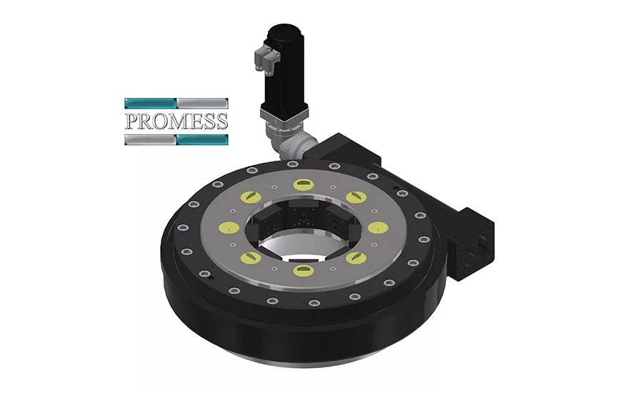

Incorporating sophisticated sensing and control technology, the Radial Press applies precise, even radial loads around the circumference of components or assemblies. The press is a fully programmable system using the UltraPRO controls platform. This platform allows for precise pressing commands, including moving to a specific force (minimum, maximum, average or combined), moving to a position, or moving to a rate of change.
Independent force feedback integrated into each internal actuator, along with high-accuracy encoder feedback, enables the product to handle a variety of radial crimping, joining and forming applications with precision. The software provides comprehensive graphs for each assembly, along with pass-fail indicators and full part history to monitor trends and facilitate adjustments. With a variety of configurations and force ranges, the press can be tailored to meet specific application requirements.
