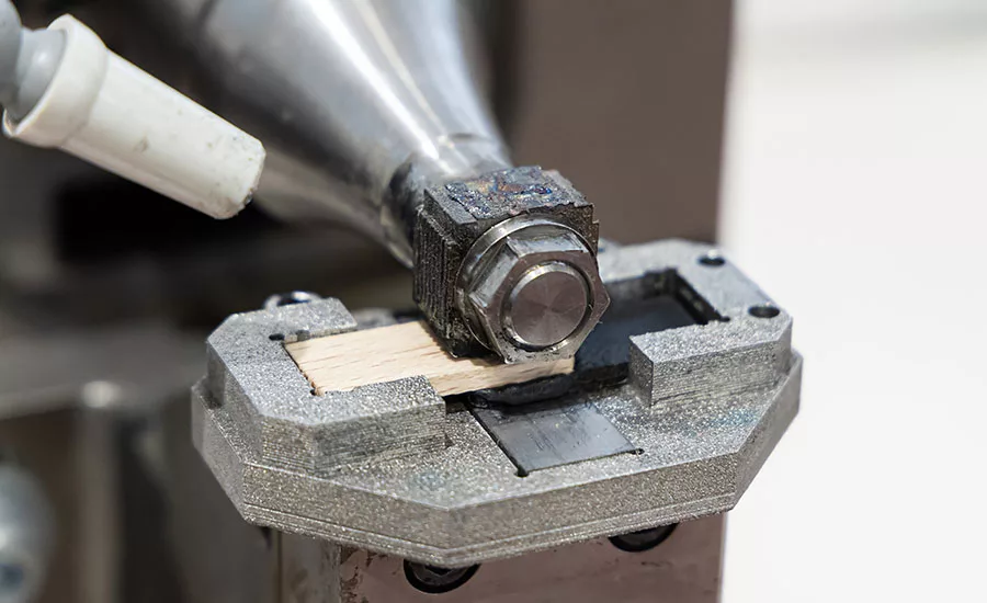

Photo courtesy Graz University of Technology

Amancio and his colleagues also experimented with ultrasonic joining technology. They applied high-frequency vibration with low amplitude to wooden components using a sonotrode. In contact with the base component—polymer or a polymer composite material—the friction generates heat at the interface which melts the surface of the polymer part. Molten polymer infiltrates into the naturally porous surface of the wood.
“In this way, a very stable spot joint can be achieved, from a mixture of mechanical interlocking, because the melted plastic solidifies again in the wood and adhesion forces,” says Amancio. “This technique is particularly suitable for large components and 2D structures, since we achieve a precisely localized spot joint.”
