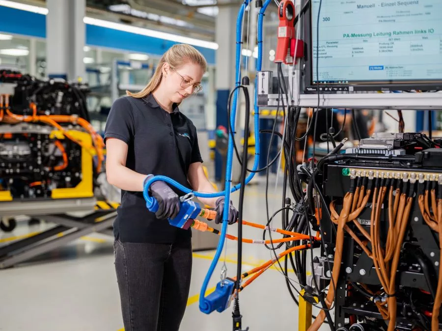

MANNHEIM, Germany—Mercedes-Benz Trucks has begun assembling a key component of its new eActros 600 long-haul truck at its factory here. The “front box” is a complex module that contains several control units, high-voltage components and an electric air compressor. It’s located in the space previously occupied by an internal combustion engine.
In contrast to a traditional diesel engine, the front box doesn’t have a specific drive function, but contains a large number of components that are essential for the truck to operate. In total, there are more than 1,000 individual parts.
Packaging this high number of components in a very confined space was a challenge to engineers. They developed a “layered structure” in which the individual components are built up from bottom to top.

The front box assembly line consists of four consecutive production sections. Each contains various assembly stations, with the corresponding material zones and subassembly stations located to the side.
After each workstation, the front box passes through a quality gate, where the correct execution of the assembly process is verified before the next level is built. Once all quality gates have been successfully passed and the assembly quality has been confirmed in an end-of-line inspection, the front box is shipped to Mercedes-Benz’s final assembly line in Wörth.
All operators have been trained in a new high-voltage training center. According to Moch, the facility provides “a practical learning environment in which participants can gain comprehensive knowledge of the latest high-voltage and battery technologies. Innovative teaching methods are used for this purpose, such as virtual reality glasses and augmented reality technology.”
