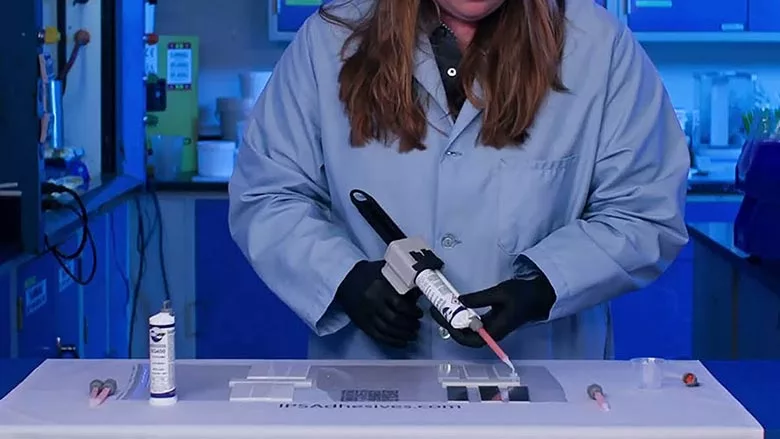

testing adhesive on sample parts
Most suppliers will test their adhesives on sample parts.

  • Test results. LSE adhesives are relatively new on the market, so many companies may still be testing their adhesives on various materials, but some results are emerging. Most vendors will publish what they have tested and will provide samples so you can do your own testing.

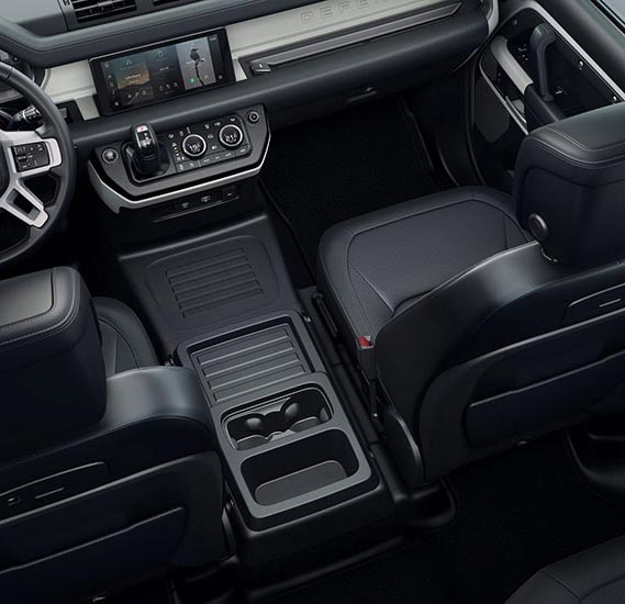

center floor console trim, front-seat back boards and instrument-panel trim of an SUV
In the automotive industry, PP is used for a variety of interior, exterior and under-the-hood applications. For example, the material is used in the center floor console trim, front-seat back boards and instrument-panel trim of this SUV. Photo courtesy Jaguar Land Rover

The transportation industry, especially the automotive industry, is among the largest consumers of PP, because of its light weight and moldability. To increase surface energy, many automotive manufacturers rely on plasma surface treatment, which can be expensive. Removing this step from the process can save thousands of dollars and shorten overall cycle times.
