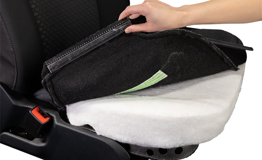

To address those issues, Magna engineers recently developed a new line of products called EcoSphere that combine sustainability with performance. They feature monomaterial polyethylene terephthalate with 100 percent melt recyclable foam.
“You can take those components off and turn them over to a recycler that can mechanically grind it up, melt it down and create new polyester fibers,” says Young. “That creates a circular economy that can be used over and over again. Currently, it’s too difficult to disassemble a seat at a vehicle’s end of life.
eco-friendly car seats
Eco-friendly car seats are an alternative to traditional animal leather and synthetic skins. Photo courtesy Magna International Inc.
“The EcoSphere product line focuses on the trim cover assembly, the trim foundation, the base pad assembly and structures,” Young points out. “This enables our seating materials to be repurposed and reused in the creation of new polyester products, contributing to a circular economy approach. Our technology offers automakers a game-changing opportunity to enhance sustainability without compromising comfort, quality or performance.”
Aside from cost, one challenge faced by Magna’s engineers was ensuring that the performance of these products meets or exceeds automotive-grade specifications. To address that issue, they looked beyond material specifications and ran products through complete seat testing to make sure that all functional objectives were still being met, such as comfort, durability and safety. “Typically, seats are assembled with clips, hook-and-loop fasteners, or hog rings to tie trim covers down to the foam pad assembly,” says Young. “We developed a way to continue using that same exact process, but do it in a sustainable way. With EcoSphere, we still keep those components attached and don’t have to worry about disassembling them. Because everything is monomaterial, it can all get recycled as a single assembly component.“
EcoSphere is not currently in any production vehicles, but we are working with several OEMs to get it launched,” explains Young. “It will be available within the next year or two. We’re also trying to determine where else this technology can be used in other automotive applications.”

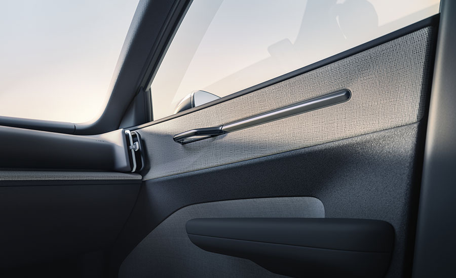

“There is a growing global demand for integrating bio-based materials as automotive OEMs respond to consumer expectations and regulatory pressures to decarbonize vehicles and embrace circular consumption models,” adds Per Mårtensson, Ph.D., chief revenue officer at Bcomp Ltd., a Swiss company that specializes in lightweight materials made with flax fiber.
“Natural materials are extremely efficient when used and applied in the right way,” claims Mårtensson. "Flax is an easy-to-care-for and highly robust plant that has been used as a raw material for linen in the textile industry for millennia.”
 Today, 75 percent of the world's scutched flax fiber is cultivated in western Europe. Bcomp’s natural fiber materials are already used in Cupra, Polestar and Volvo vehicles. In 2023, the Volvo EX30 compact electric SUV became the first production vehicle to use Bcomp’s ampliTex fiber composites for its dashboard and doors. The Polestar 3 is an electric SUV that also uses the robust flax-based material for various interior trimmings, such as seat backs.
“Compared to conventional plastic trim, this can save more than half of the petroleum-based raw materials,” says Mårtensson. “Additionally, the material shines with its unique lightness and enables reduced vibrations."
 “However, the issue of consumers’ general unwillingness to pay a premium for vehicles containing less plastic and more bio-based or recycled materials is compounded by the fact that plastics benefit from highly optimized and cost-effective supply chains rooted in linear consumption,” adds Christian Fischer, CEO of Bcomp. “[That is] without factoring in the environmental costs of landfilling at the end of a vehicle’s life.
“[Our products] address this gap by offering added value, such as lightweight design, high-performance and customization, enhancing the demand for bio-based materials, despite cost pressures,” notes Fischer.
“In [our] experience, this growing trend is most pronounced in Europe, where bio-composites are helping OEMs meet increasingly stringent regulatory standards aimed at reducing carbon footprints, improving recyclability and adhering to end-of-life vehicle directives,” says Fischer. “While the trend toward sustainability has been evident for years in Europe, it is now gaining traction worldwide, with increasing interest in the United States and Asia.”

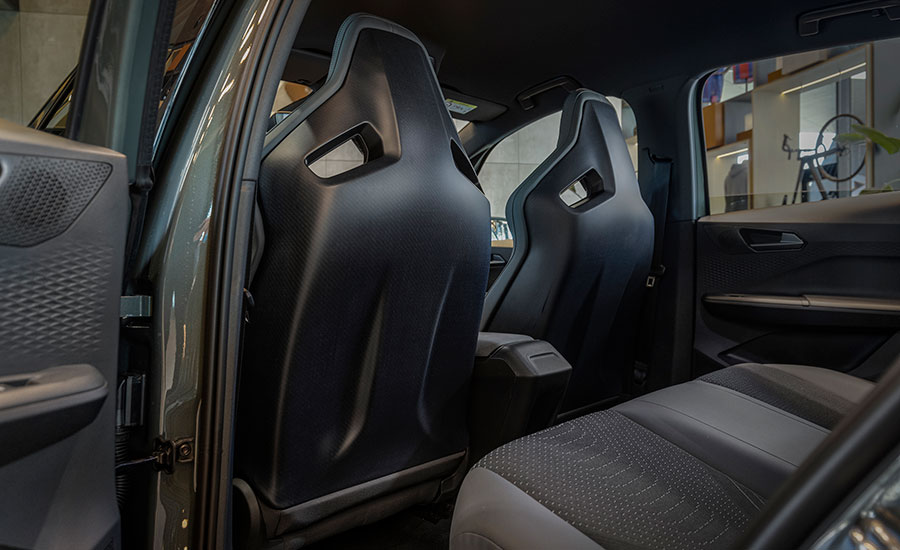

Bcomp has been working with engineers at BMW AG to develop applications for ampliTex and powerRibs. They recently created a lightweight seatback that features a natural fiber layup. The award-winning design took circularity and recyclability into account right from the start.
“We are already using existing technologies and materials to provide an outlook on the possibilities for reducing emissions and conserving resources in the future,” says Falco Hollmann, innovation manager for lightweight construction and sustainability at BMW. “This is not just about the substitution of materials, but above all about the topic of design for circularity.
“By combining the structural and aesthetically pleasing visual properties of the material in one manufacturing step, production is both more efficient and dematerialized,” explains Hollmann. He says less complex assemblies and materials that can be separated by type will enable the recyclability of the seat at the end of its life.
“Flax fiber composites are CO2 neutral from cradle to grave and can reduce manufacturing-related emissions of high-performance composite parts by up to 85 percent [vs. traditional] carbon fiber,” claims Hollmann. “Compared to current large-scale automotive plastic parts, flax fiber materials can reduce component weight by up to 50 percent, due to their low density and high stiffness.”

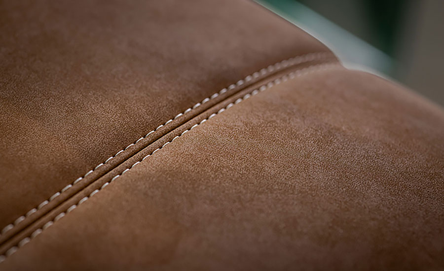

NFW recently developed a non-petroleum-based leather alternative for car interiors. Mirum is made from natural rubber, natural fibers, plant oils, natural pigments and minerals. It provides superior durability and quality that can replace traditional animal-based or synthetic leather products without the use of any polyurethane or other coatings.
