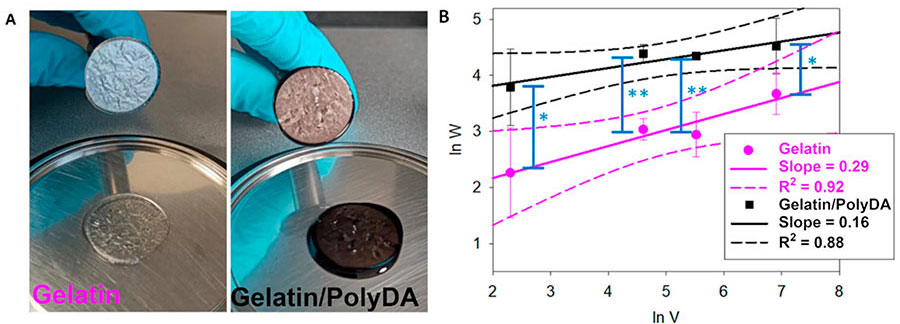

Because these behaviors depend on dynamic bonding, the kinetics of reversible motifs play a central role in determining macroscopic adhesion. The characteristic relaxation time (t) or association (kon) and dissociation rates (koff) set the timescale for reversible vs. dissipative responses. When deformation is slower than 1/t, reversible bonds reorganize during loading, producing moderate adhesion and reversible-set behavior. At rates faster than 1/t, bond rupture becomes effectively irreversible, yielding higher peak forces and dissipative, often cohesive, failure.
Plotting adhesion strength against pulling rate (rate x t) defines a characteristic triggerable debonding window, showing how hydrogel adhesion can be modulated by strain rate. Such rate-dependent adhesion trends have been reported across diverse hydrogel adhesives, where measurements of pull-off force or peel energy as a function of deformation rate reveal characteristic interfacial and bulk-dominated properties.
This mechanistic framework links hydrogel structure and bonding dynamics to macroscopic performance. Therefore, from an adhesive perspective, hydrogels present several intrinsic advantages. Their low polymer-chain density imparts softness and flexibility, depending on polymer composition and concentration, crosslinking density, swelling ratio, temperature, presence of additives, and other factors. Their high water content ensures hydration, facilitates ion and molecule diffusion, and supports stimuli-responsive behavior.
