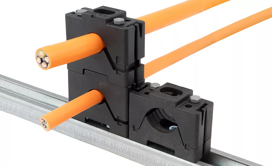

The MSMC modular stackable cable clamp is a flexible fastening system for cables, pipes and cylindrical components with a diameter of 10 to 55 millimeters. Thanks to its modular design, it enables a simple and quick expansion by connecting or stacking several clamps.
The stacking or connecting principle allows several clamps to be combined. The CMC30 connector can also be used to connect clamps with different clamping areas of the same size. The clamps and the screws, made of zinc-nickel-passivated material for protection against corrosion.
Longitudinal and cross ribs on the support surface ensure high stability and reduce torsion. A slotted hole as a central tightening point enables flexible fastening options on different surfaces.
The clamp consists of an upper and lower part, as well as hexagon screws. The connector allows several clamps to be connected in a row. To increase stability and torsion resistance, two long screws can be used for fastening.
