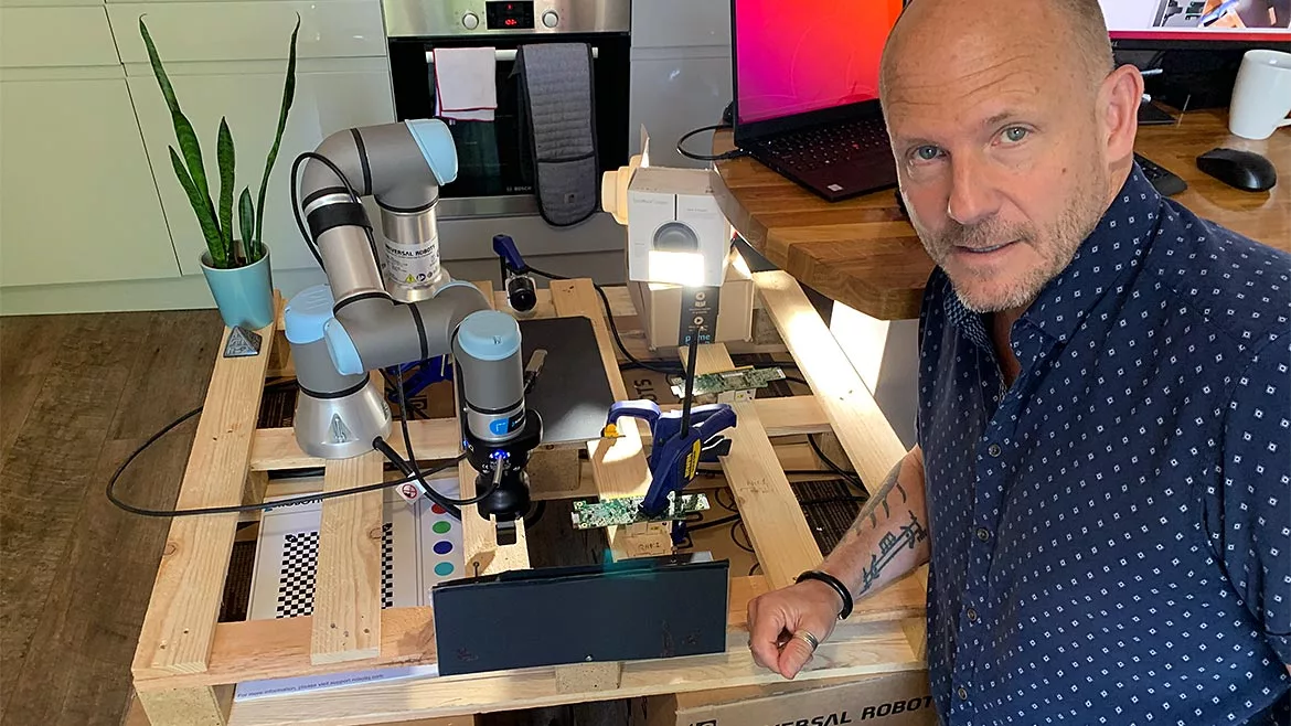

One illustrative application where I was able to demonstrate the true value of including a neural network in a robotic application was for a connector alignment and robotic insertion project for electronics assembly and Data Center automation. The idea was to pick up a fiber-optic network plug and insert it into the associated socket. Robotic connector insertion is typically difficult as robots lack human visual understanding and our fine motion and force following skills. Furthermore, this plug is quite long and has a high aspect ratio, and the socket has a very small entrance aperture requiring precise alignment to correctly insert without damage. Strong arming the connector into the socket with a traditional rigid robot is risky; we can use force following, a gentle cobot, a lot of compliance, and a spongy gripper to stack the deck in our favor, but the initial alignment in XYZ and Roll, Pitch, and Yaw need to start out better than 0.1mm and 1 degree.
A traditional robotic approach would be to use either 3D sensing cameras or multiple 2D cameras and calibrate those against the work cell and robot coordinate systems. We would then visually measure the orientation of the plug relative to the gripper after it has been picked up, and also find the socket location in precise 3D space. Next, we would program several very specific 3D geometric offset calculations to determine where the plug needed to be in 3D space. Finally, we would compute a robot reverse kinematic solution to determine necessary joint angles to get to the correct approach pose.
This is all standard vision-guided robotics stuff, but it is time-consuming and confusing. It is also fragile. Clean a camera lens and slightly bump it, and all the robot calibrations must be redone.
VS 0923 System Integrate Training Data
Sample of training data automatically collected to train the neural network to convert between camera coordinates and robot coordinates. Image courtesy of Ned Lecky
Do It With ML!
I chose a different approach that completely avoids all traditional vision/robot calibration. We’ll just measure offsets in cameras placed wherever convenient, and we’ll see how those offsets vary as we run a program to move the robot in and out of alignment. That will make a training dataset that will allow our neural network to just figure out how everything relates—linear or not, independent axes or not.
I used two 2D cameras in whatever position was easy to mount them and used standard pattern matching tools to find the socket and the plug and to measure their positional and angular offsets in uncalibrated camera coordinates.
A human-certified visual alignment of the two is made to start the calibration. Then, a simple robot program moves the plug around in all six axes and we simply measure what we see in each camera. This automatically builds a training database that correlates misalignments we see in the cameras with known plug-socket offsets in the physical world.
Feeding this data into a multidimensional linear regression machine learning algorithm should work, since this all “should” be linear. It turns out that there are strange nonlinearities in the images due to lens nonlinearities that are not calibrated. No worries! I just used a neural network instead, and it sees what we normally would call intrinsic calibration, extrinsic calibration, and hand-eye calibration automatically without needing to deep-dive or compute any of those things explicitly.
As noted earlier, neural networks don’t really care if the functions are linear, and they certainly don’t care if the variables are not independent. They are architected to assume that things may be nonlinear and that your input variables are somehow dependent on one another. I built and trained my neural network in TensorFlow and PyTorch, and also built a real-time version in C to show how easily deployment could be. The total number of lines of “ML-specific” code in the application was under 100, and you can get the bulk of them from online resources including simple Google searches, coding help websites, and ChatGPT.
