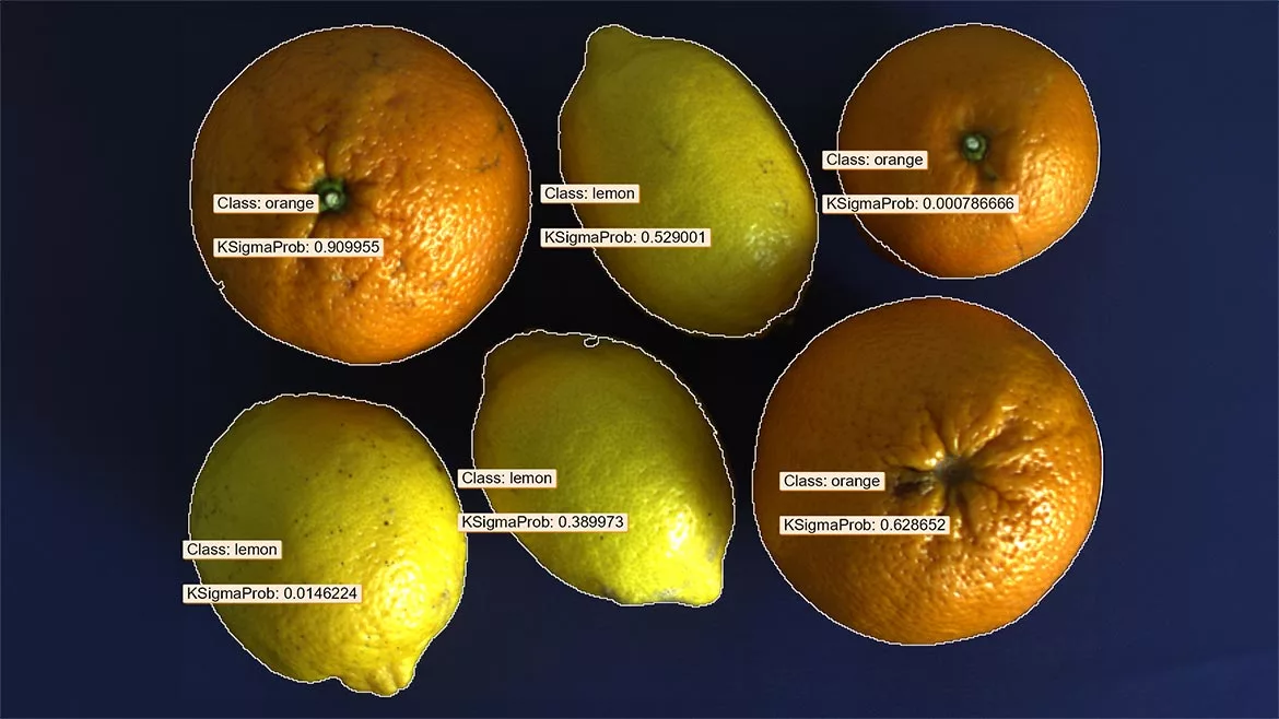

In this example (Image 1), a GMM model is created to show a simple classification of fruit. Features selected to define the differences between the classes are object circularity and object area. Note that other features (like color) could be added to improve reliability. As mentioned, the value of the tool is that the classification is performed and tuned with little intervention.
