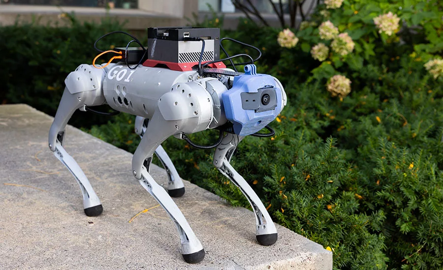

quadruped robot learns parkour
This robot derives its parkour behavior from reinforcement learning.

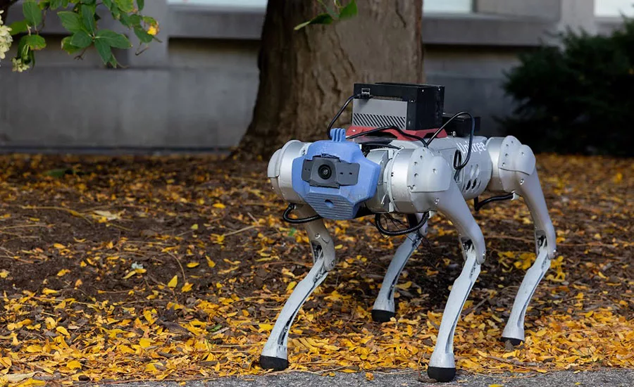

quadruped robot learns from synthetic data
Combining generative AI with physics simulators enables a quadruped robot to learn from synthetic data rather than real-world experience.

Parkour is a high-energy sport that involves jumping and climbing between challenging objects and obstacles. It’s hard enough for most humans to tackle.
But, imagine teaching a robot to do parkour without ever letting it see the real world. That’s exactly what engineers at the Massachusetts Institute of Technology (MIT) Computer Science and Artificial Intelligence Laboratory (CSAIL) have done. Their LucidSim system combines generative AI with physics simulators to enable a quadruped robot to learn from synthetic data rather than real-world experience.
Robots trained using these machine-generated environments succeeded 88 percent of the time, while those taught by human experts managed only 15 percent. When the engineers doubled the AI-generated training data, performance improved steadily, showing that more virtual practice leads to better real-world performance.
This approach could help solve a problem plaguing robotics: the need for extensive real-world training data. It’s a practical step toward developing machines that can adapt more quickly to new tasks and environments. The goal of the R&D project is to teach robots to encounter scenarios that push the boundaries of their capabilities.

LucidSim moves what currently takes place in the physical world into software. Yang and his colleagues use generative AI to systematically create diverse, rich-looking scenarios with little effort. The data from LucidSim is also higher quality. Robots learn via closed-loop training, where the data directly reflect the machine’s own actions.
AI plays two important roles in LucidSim. First, a variant of text-to-image diffusion models called control net gives the engineers control over the geometry of the scene that appears in the generated images.
“These networks can be prompted via text, which gives us a way to specify the image content using human language,” says Yang. “We found that if we control the geometry, the same text prompts tend to produce similarly looking images. This is great for reproducibility, but it translates into data that are not diverse at all.
“So, to make the images diverse, we decided to programmatically collect a large number of text prompts from chatGPT,” notes Yang. “Our setup allowed us to quickly generate a large number of different scenarios, and this is how we get the robot to work.
“Our robot derives its parkour behavior from reinforcement learning,” explains Yang. “The robot policy that we deploy is distilled from a teacher policy trained ahead of time using reinforcement learning on a lot of data.”
Yang and his colleagues generated realistic images by extracting depth maps, which provide geometric information, and semantic masks, which label different parts of an image, from the simulated scene.
But, they quickly realized that with tight control on the composition of the image content, the model would produce similar images that weren’t different from each other using the same prompt. So, they devised a way to source diverse text prompts from ChatGPT.
This approach, however, only resulted in a single image. To make short, coherent videos that serve as little “experiences” for the robot, the CSAIL engineers hacked together some image magic into a technique they dubbed “Dreams in Motion.”
The system computes the movements of each pixel between frames to warp a single generated image into a short, multi-frame video. Dreams in Motion does this by considering the 3D geometry of the scene and the relative changes in the robot’s perspective.
