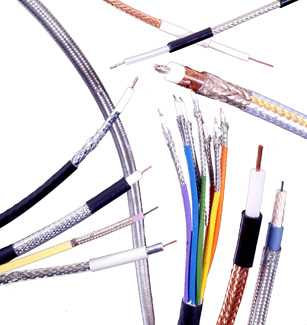

Harness braiding is a process that involves covering wire bundles with protective sleeves made of woven materials. It’s used for a variety of applications, including everything from large aerospace and automotive parts to tiny microelectronics and medical devices.
Advantages of braided wire harnesses include abrasion resistance, electrical insulation, impact resistance and temperature resistance. It provides an extra layer of insulation and protection from chemicals, electromagnetic interference, fluids, heat, moisture, moving parts, squeaks, rattles and vibration. Wire harnesses with braided sleeves can withstand harsh environments and ensure the uninterrupted flow of electrical signals.

braiding
Braiding covers wire bundles with protective sleeves made of woven materials. Photo courtesy Wardwell Braiding Co.

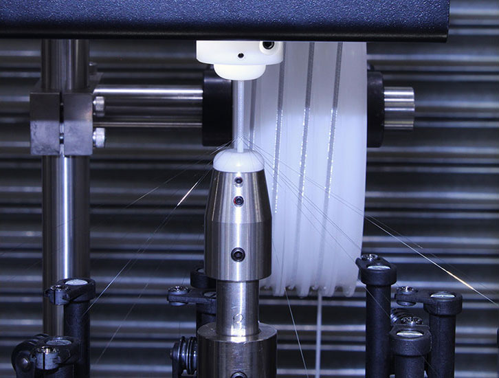

“Our niche is being able to braid tiny wires and fibers, which are especially in demand for minimally invasive medical devices,” says Sean Hargett, president of Steeger USA Inc., which has been making braiding equipment for more than 150 years. “Our machines process wires as small as 0.0005-inch and 5-denier single filament fibers.”

mandrel feeder
This mandrel feeder is designed to ensure tension and precise placement of wire braiding material. Photo courtesy Steeger USA Inc.
