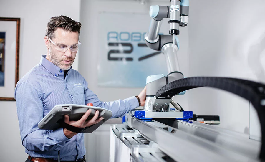

Linear Axis Extends Range of Cobots
The Movotrak cobot transfer unit is a linear actuator that serves as a 7th axis of motion for collaborative robots. With a horizontal range of up to 10 meters, the axis is equipped with collision detection technology that stops the cobot when it encounters an obstacle.
“With the extension of the cobot’s collaborative functionality along the 7th axis, manufacturers can deploy cobots to work more closely and flexibly with humans. Using the same cobot for more than one workstation boosts productivity and extracts maximum value from the initial cobot investment,” says Kyle Thompson, product innovation manager at Thomson.
The actuator features a Kollmorgen servomotor and linear guide rails that move a cobot smoothly from one location to another. However, unlike conventional 7th axes, the Movotrak has collision detection functionality similar to a cobot joint. Engineers adjust collision sensitivity settings on a control tablet during setup, and the motor drive and digital I/O manage the collision monitoring and shutdown.
The collision detection system also monitors current continuously, detecting position errors in the motor, and providing comprehensive anti-collision capabilities along the entire 7th axis. The system includes a small reverse-move feature that eliminates pinch points following a stop.
The device integrates seamlessly with many cobot sizes and brands, including Universal Robots (UR), which allows all programming to be done directly through a URCap interface on its teach pendant. All collision monitoring and safeguard logic runs in the Thomson drive, so bandwidth competition with the UR controls is minimal.
Just as cobots can be programmed through a “free drive” setting, engineers can manually set waypoints on the linear track. Engineers manually slide the cobot where they would like it to be in a sequence along the 7th axis and register that with a push button.

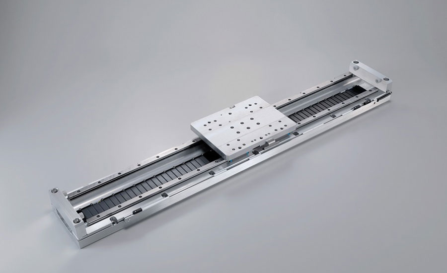

LT170H2 direct-drive linear motor stage
Image courtesy of IKO International.
High-Thrust Linear Motor Stage Delivers Long Stroke Lengths
The LT170H2 direct-drive linear motor stage is for dynamic applications, such as measurement, assembly and semiconductor fabrication, that require high thrust forces and long strokes. It delivers 260 newtons of rated force and a maximum force of 500 newtons.
Its redesigned linear motor leverages direct-drive technology that is free of mechanical power transmission parts that can otherwise hinder positioning accuracy. The stage also comes with C-Lube linear bearings for guidance. Together, they allow the positioning stage to achieve higher thrust forces and high speeds with precision.
Maximum speed is 3,000 millimeters per second. Maximum stroke length is 2,750 millimeters. The stage is 170 millimeters wide. The stage consumes approximately 48 percent less power than the model.
