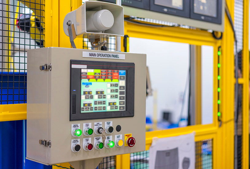

working with robots
Robots, AGVs and other automation systems can create dangerous workspaces—without the proper safeguards.
Photo courtesy DigiKey
April 23, 2025
As manufacturing becomes increasingly automated, manufacturers must find ways to protect their most important asset: their workforce. Robots, autonomous vehicles, material handling equipment, and more complex systems can create dangerous workspaces—without the proper safeguards installed on the production floor.

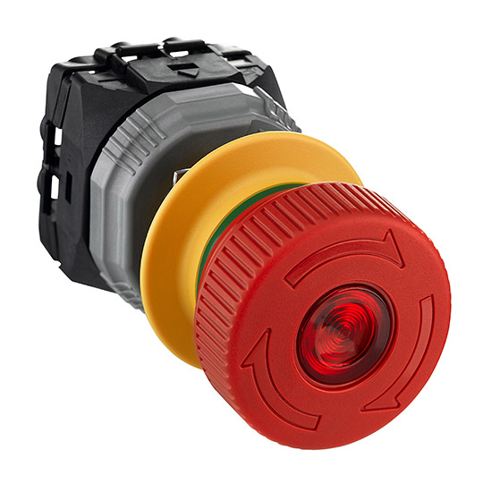

E-stop
The e-stop is typically in a normally closed position within a circuit that, when pressed, opens the circuit and cuts power to the device. Photo courtesy DigiKey
E-stops are one of the most recognizable and most thought-of safety devices on the production floor. Think of them as the immediate interface to stop a machine. The e-stop is typically in a normally closed position within a circuit that, when pressed, opens the circuit and cuts power to the device. To re-engage the circuit, the e-stop must be pulled out or in a twist to the open configuration, returning the circuit to operational.
According to OSHA, ANSI, NFPA79, ISO 13850 and IEC 60204-1, e-stops are required to be installed where they are easily accessible to the operator. Resetting the e-stop should not allow operations to resume. A second redundant action is required, such as an all-clear function through a circuit on the programmable logic controller (PLC).
