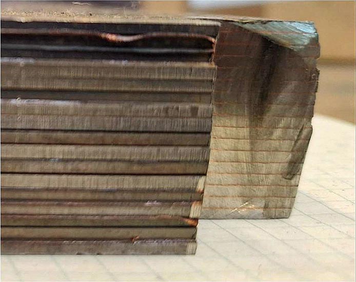

multiple layers of stainless steel and copper welded into a single solid block of material
The photo (left) and micrograph (right) show multiple layers of stainless steel and copper welded into a single solid block of material. Photo courtesy TECNA USA Inc.
