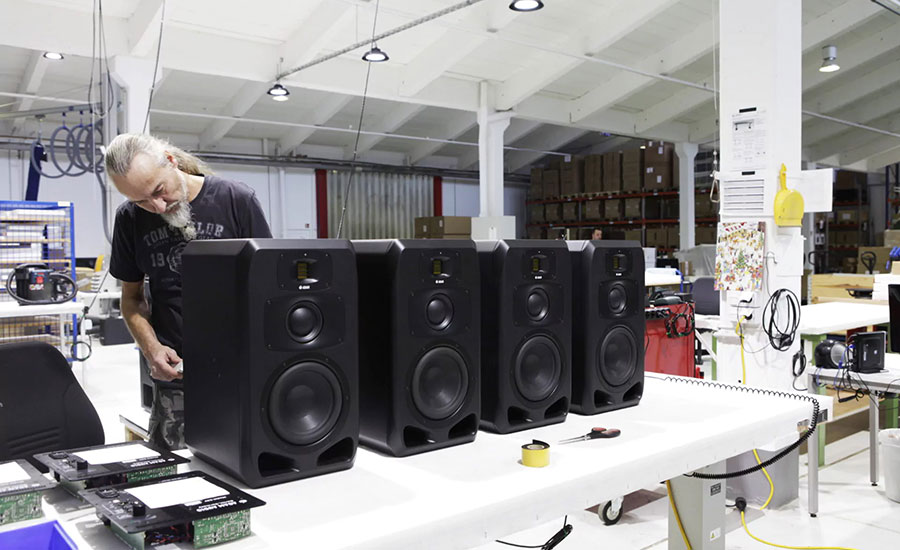

moduhub assembly table from Roemheld
The height of the moduhub assembly table from Roemheld can be adjusted via two electric lifting columns. Photo courtesy ADAM Audio

ADAM’s high-end line of speakers, the S Series, is assembled by hand at the company’s factory in Berlin. These speakers pose a physical challenge to assemblers. The largest model weighs 176 pounds and measures 17 inches tall, 35 inches wide and 20 inches deep. Simply moving the speaker around disrupted productivity. Two people are needed to move the speaker from one workstation to another, so one assembler would invariably have to stop working to help a colleague make the transfer.
For Alexandra Brau, production manager at ADAM Audio, it was clear that the manual assembly area had to be reorganized. “We wanted to be flexible and create an innovative working environment that also meets the high standards we set for our products,” she says. “We did not want a standard solution, and we did not want an assembly line.”
Brau had three goals for the reorganization. First, assemblers should be able to push or pull speakers during transfers, instead of lifting them. Second, the worktables should be adjustable in height. For safety reasons, it was important that the height of the work surface could only be changed on demand. Brau did not want any accidental drops of the work surface. Finally, lifting and lowering must be vibration-free and jerk-free to avoid damaging the speakers.

After extensive research, ADAM decided on moduhub assembly tables from Roemheld GmbH in Laubach, Germany, a suburb of Frankfurt. The height of the tables can be adjusted via two electric lifting columns. The tabletops—each 3,000 millimeters wide, 800 millimeters deep and 60 millimeters thick—carry a load of up to 880 pounds.

At ADAM, the assembly tables are at the heart of the reorganization. Their operation is simple and safe. To raise or lower the height of the worksurface, assemblers simply need to push a button on a control panel. As long as the button is pressed, the two lifting columns move up or down synchronously, evenly and quietly at a speed of between 12 and 16 millimeters per second, depending on the load. If the button is released, the lifting columns stop immediately.
Different positions can be preset and recalled from memory. The electrically controlled soft start and stop also contribute to the ease of use.
To mount a speaker or subwoofer, the assembler moves the components to his worktable on a transport trolley. From memory, the table adjusts its height to be slightly lower than that of the trolley, so that the assembler can pull all components onto his work surface comfortably and without help. Next, the assembler adjusts the height of the tabletop to the optimal position based on his stature and the size of the speaker.
After assembly, he positions the work surface to be slightly higher than that of the transport trolley (that position is also stored in memory) and pulls the fully assembled speaker onto the trolley.
