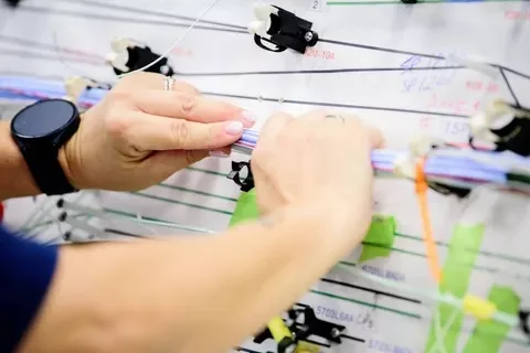

Quality is the No. 1 concern of wire harness assemblers today. Photo courtesy Airbus
