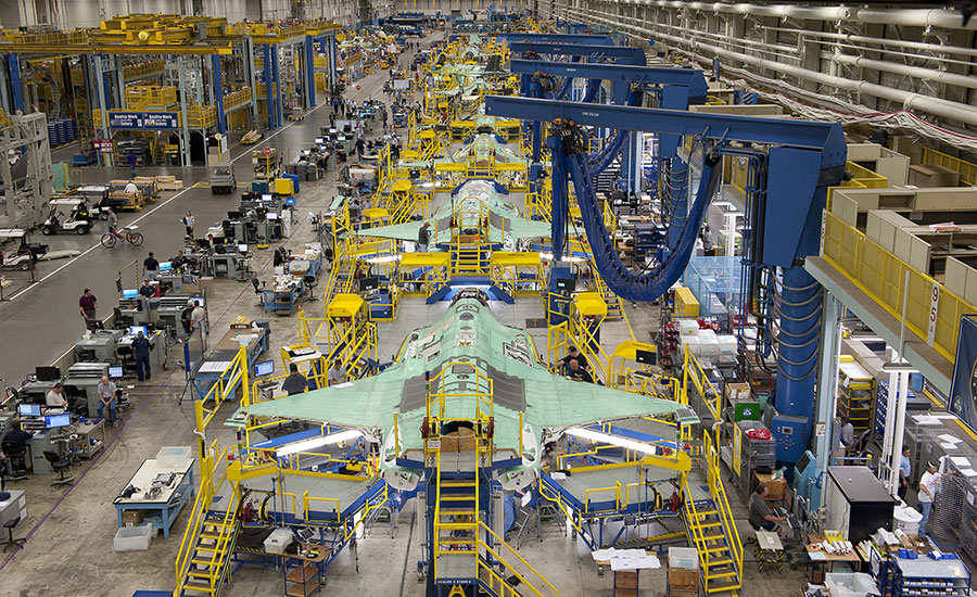

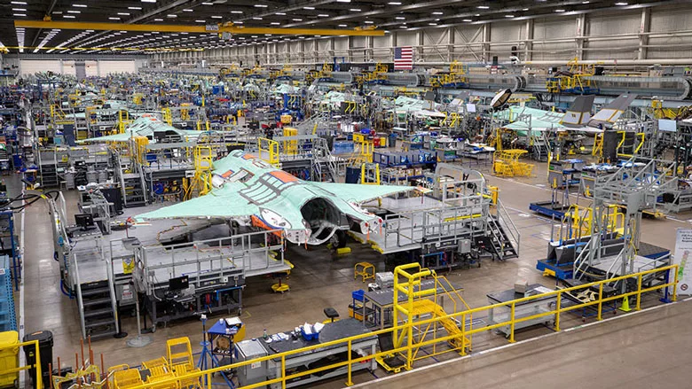

Lockheed assembly plant in Fort Worth, TX
Lockheed manufactures fighter aircraft at a sprawling assembly plant in Fort Worth, TX. Photo courtesy Lockheed Martin
