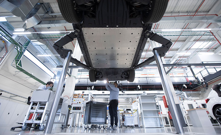

By Nathan Eddy
electric vehicle chassis
Illustration courtesy ZF
Electric vehicles pose new chassis challenges for engineers, such as packaging, structural reinforcement and crash management.
February 6, 2026
