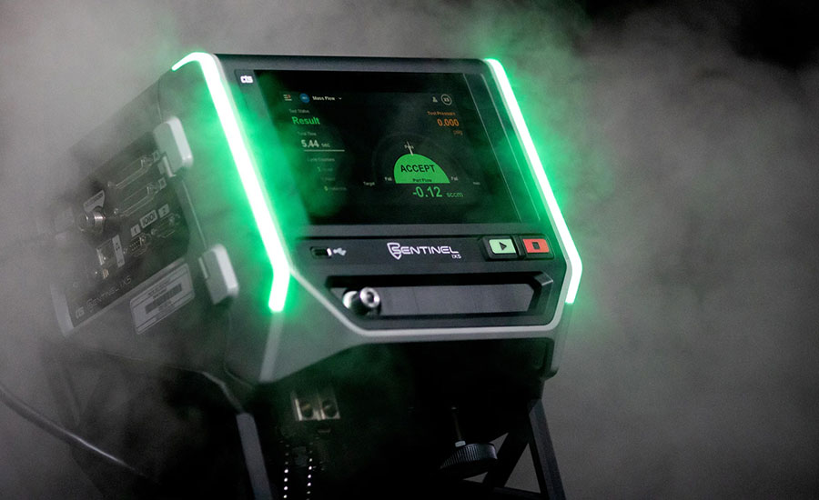

Leak Testing Platform Is Multifunctional
Sentinel IX5 leak testing platform
Photo courtesy Cincinnati Test Systems
The Sentinel IX5 is a multifunctional platform for pressure, flow and vacuum leak testing. It features an entirely new design and many enhancements that make leak testing even more accurate, user friendly and efficient. A simple touchscreen interface provides easily accessible menus, customizable screen view options and real-time visualized data. Users can tap, build and visualize all steps in test sequences, and preview a test before running it. Improved resolution and accuracy enable shorter cycle times. Advanced controls automatically adjust for changes in temperature and pressure.
See this company at The Manufacturing & Automation eXchange March 24-26 in Nashville, TN.

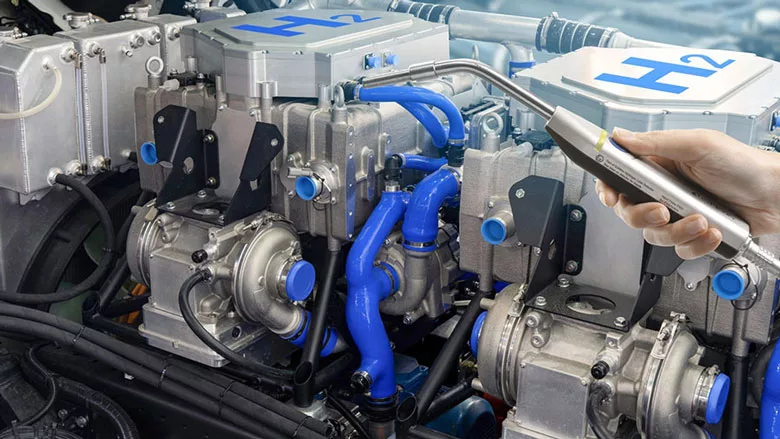

Hydrogen Leak Detector Is Portable
Extrima portable leak detector
Photo courtesy Inficon Inc.
Extrima is a portable leak detector that can be used in hazardous locations. It quickly detects leaks across a wide range of industrial systems where pure hydrogen is used without compromising safety. Applications include hydrogen systems, hydrogen-cooled generators, vehicle fueling stations and fuel systems. The device can also be used on components like valves, regulators and pressure gauges where a nonflammable gas mixture of 5 percent hydrogen in nitrogen is used as a tracer gas. Even minute leaks can be detected with pinpoint accuracy.
