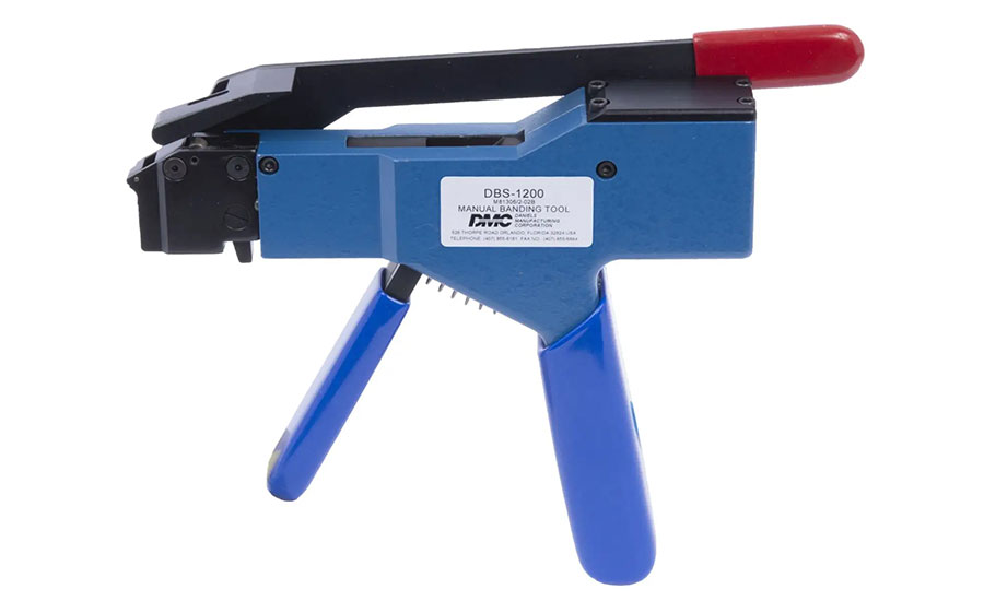

DBS-1200 Pneumatic Banding Tool
Image courtesy of Daniels Manufacturing Corp.
Pneumatic Banding Tool Is Operator-Friendly
The DBS-1200 is designed to install 0.25-inch M85049/128 welded buckle bands. It can be used with either M85049/128-5 flat or M85049/128-6 coiled bands. The tool tensions and cuts the band, leaving an extended cut-off tab. Cut-off blades are replaceable. The PBT1200 pneumatic banding tool is also available for improved ergonomics in high-volume production environments. The DBS-CG1 laboratory calibration instrument allows operators to measure the exact tension produced by the tool.
