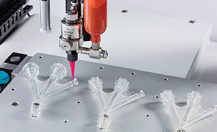

Manufacturers can minimize waste by using the proper adhesive dispensing components. Photo courtesy Nordson EFD

One-component epoxies can be used straight from the tube. No mixing, metering or degassing is required. However, these epoxies require heat for curing. One-component versions have an initiator, which is the heating element, contained along with the resin. The epoxy then requires an oven or other heating mechanism to reach full cure. Typical cure times are 30 to 60 minutes at 350 to 400 F. Handling strength can be achieved rapidly with induction cure. Curing time for this is usually 6 seconds at 325 to 425 F. However, heat curing must follow induction curing for the epoxy to reach full cure. Ultraviolet light-curing epoxies are also available in one-component versions.
Two-part epoxies are the most common. These epoxies require the user to mix a resin and a hardener. Hardeners trigger the polymerization required for curing. When the two are mixed, either mechanically or by hand, an exothermic reaction occurs as the molecules begin to cross-link. When a full cure is reached, the bond is essentially a hard piece of molded plastic, says Bongiorni.
Two-part versions are somewhat stronger than their one-part cousins, because of their different curing characteristics. "You have a chemical reaction going on between the resin and hardener, and they form something that is bigger than either of them by themselves," says Bongiorni. Two-component epoxies can be cured at either room temperature or elevated temperature. They can achieve handling strength in 5 minutes to 8 hours, depending on the type of curing agent used. The most commonly used epoxies solidify in 2 to 3 hours at room temperature. A catalyst can be added to speed the reaction between the resin and hardener.
However, all epoxies should be allowed to cure 5 to 7 days at room temperature before testing.
Choosing the Correct Type
Two-component epoxies allow assemblers to bond almost anything. "When you bond something with two parts, you can get a fierce chemical reaction. Therefore, you tend to have better physical properties," says Bongiorni. But over the years, one-component epoxies have been getting better.
One-component epoxies are excellent for assembly lines or areas where users would place a drop of epoxy on one part in an assembly process where two parts of an assembly are being mated together. The assembly would then travel into a heat source for its curing cycle. One-component epoxies are easier to use in an original equipment manufacturer operation, because no mixing is involved. With metering and mixing eliminated, rejects can be lower due to incorrect hardener and resin ratios. Arnon agrees. "The perfect example would be a company that we dealt with a while ago. It was using a two-component epoxy to bond painted components. The painted components would then go through an oven to cure the paint. After viewing the process, we changed the company's two-component epoxy to a one-component version. Because the assembly process already included an oven-curing stage for the paint, the heating process cures the epoxy simultaneously. This enabled the company to eliminate mixing the two components together. By eliminating the mixing, you are also eliminating the mixing equipment and problems with incorrect ratios. The company also eliminated pot life problems," says Arnon.
According to Arnon, in the end, choosing one over the other is going to depend on the specific application. "The advantage with the single-component epoxy is that you don't have to mix it. If you put it in a dispensing machine, you don't have to flush it. But the disadvantage is that you need heat to cure it. The advantage of the two-component epoxy is that it can cure at room temperature, so you don't need heat. But the disadvantage is that you have to mix it. So if you have a part that later on goes through heat for another application, you might want to use a one-component epoxy if you can. That way, you'll eliminate mixing time and equipment purchases," concludes Arnon.
