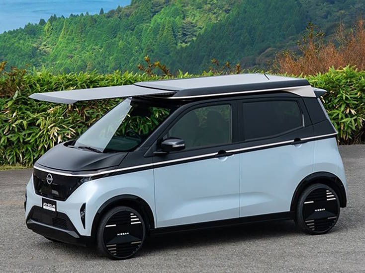

Nissan's roof-mounted Ao-Solar Extender solar panel
An extendable roof-mounted solar panel charges this EV while it is in motion and when it’s parked. Photo courtesy Nissan Motor Co.

At last October’s Japan Mobility Show, Nissan Motor Co. launched a version of its best-selling EV with an optional solar panel. The roof-mounted Ao-Solar Extender can charge the compact Sakura Kei both while driving and when parked. Its name is derived from the Japanese word “aozora” (blue sky).
When stationary, an additional panel extends outward from storage, increasing the solar panel surface area and power generation potential to approximately 500 watts. The expanded panel also creates shade and helps block sunlight from entering through the windshield, reducing cabin temperature and lowering the need for air conditioning power consumption.
The system has been designed to minimize drag and integrate with the Sakura’s overall appearance. Nissan claims that, on an annual basis, it can generate enough solar electricity to power up to 1,864 miles of driving.

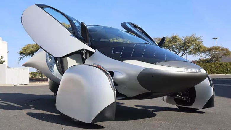

Three-Wheeled Sunmobile
The solar-powered vehicle that many people in the United States are keeping their eyes on is the much-anticipated Aptera. In March, the first $40,000 microcar rolled off the assembly line at the company’s factory in southern California. It marked a major milestone as it progresses toward regulatory certification and initial customer deliveries.
The three-wheeled vehicle, which has been in development for more than 15 years, uses multiple solar panels to reduce reliance on grid recharging. The panels wrap around the body, hood and roof of the funky vehicle, which boasts a range of up to 400 miles from a single charge in under 1 hour.
Aptera’s aerodynamic carbon-fiber composite body is covered in 3 square meters of solar cells. At least 90 percent of the power produced by the solar panels goes toward propelling the lightweight two-passenger vehicle, which can accelerate from 0 to 60 mph in 6 seconds and has a top speed of 101 mph.
Aptera integrates its custom solar panels at an in-house facility. It plans to sell them to Telo Trucks, a start-up company that hopes to soon ramp up production of a mini electric pickup truck dubbed the MT1.
Aptera’s vehicle achieves its efficiency via power electronics that convert solar energy into cylindrical battery cells made by LG Energy Solution. CTNS Co. produces the modules, which are integrated into battery packs by Aptera.
