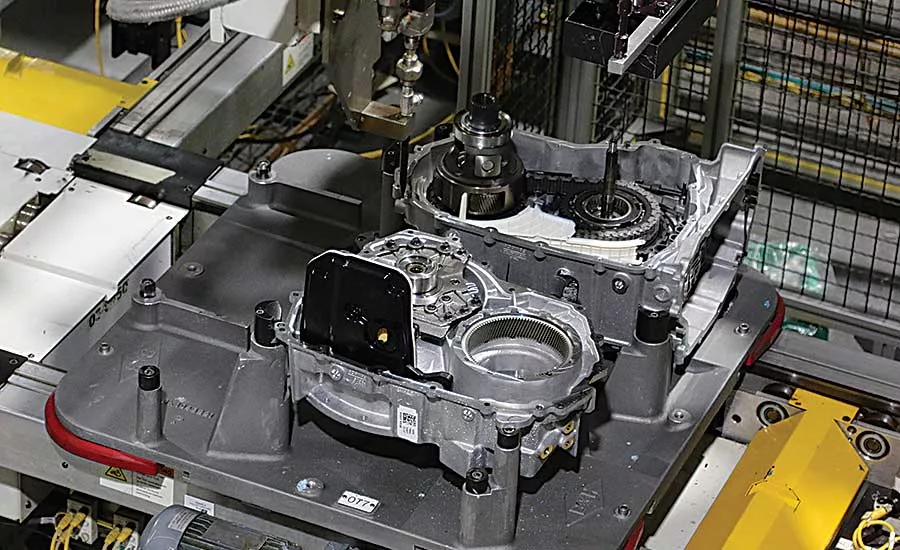

Transmissions are complex products that contain hundreds of parts and require carefully aligned gears and clutches. Photo courtesy Ford Motor Co.

Assembling automotive powertrain parts, such as clutches, requires precise alignment of gear meshing and other critical components. Traditionally, this is a manual assembly process performed by skilled operators with years of on-the-job experience. However, the repetitive motions involved present a serious risk of injury to assemblers. Quality issues can also arise from tired workers assembling heavy parts for long periods of time.
Clutch assembly is an application desperately seeking an automated solution. However, traditional industrial robots are not an option. While motions can be controlled very accurately with robots, applied forces are controlled poorly at best.
Most robotic systems use a position-based control strategy that is ineffective as an assembly tool in cases where the assembly tolerance is less than the positional uncertainty. To achieve assembly performance levels comparable to humans, industrial robots need to learn how to use force and torque feedback to recognize and correct misaligned parts.
Many assembly tasks, such as clutch gear alignment, have traditionally resisted automation because positional uncertainty was greater than assembly tolerances. The inability to control the forces of contact on the workpieces hindered applications.
