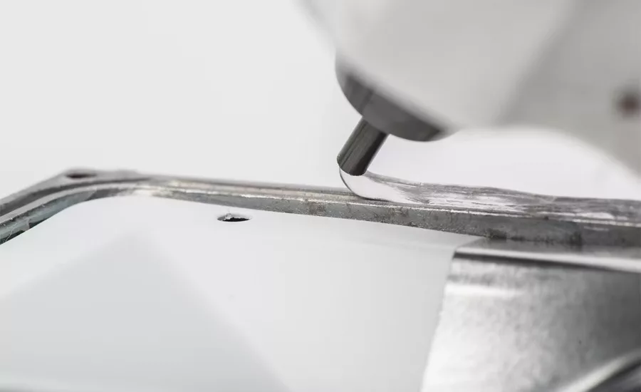

A new adhesive and sealant has been introduced that combines the best characteristics of two established chemistries-silicones and hot-melts. The new material, silicone reactive hot-melt, promises to improve performance, reduce assembly time, and decrease costs when bonding and sealing glass, metal and plastic. Photo courtesy Down Corning

A silicone reactive hot-melt adhesive combines attributes of silicones and hot-melts. Its viscosity is 210,000 centipoise at 248 F. The material has a pot life of 24 hours and an open time of 15 minutes. The adhesive is normally clear, but coloring can be added to match a particular assembly.
It has a green strength of 18 psi after 15 minutes and 28 psi after 1 hour. Fully cured, it has a tensile strength of 350 psi, and it can elongate 1,000 percent before breaking. It’s highly resistant to the elements, and it withstands service temperatures from –25 to 200 F.
