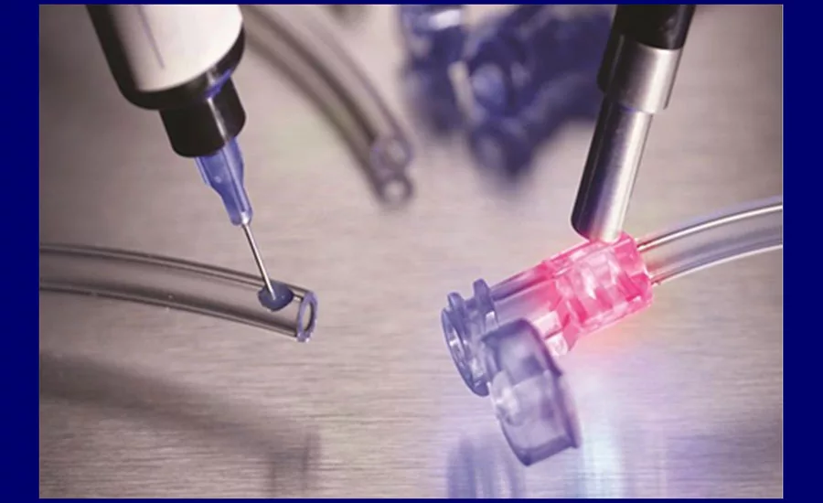

Adhesive Bonds Tubing for Medical Devices
UV-8675 is an acrylated urethane adhesive for bonding PVC, polycarbonate and other plastics. Designed for bonding PVC tubing in medical devices, it also bonds well to glass and metals. This semirigid polymer offers high bond strength without causing stress cracks. This UV-cure adhesive can be cured in thicknesses from 10 microns to 10 millimeters. It can be used in tight adhesive applications as well as for larger gap filling.
UV-8675 is a low- to medium-viscosity material that can be easily dispensed by hand or pneumatic machine. With a cure time of less than 10 seconds, it produces a tough, high-strength polymer with an elongation of 210 percent and is excellent for temperature cycling from -40 to 85 C.
It is available in 3-, 10- and 30-cc syringes, as well as 8-ounce, 1-liter and 1-gallon containers. The adhesive is nonhazardous for shipping and has a shelf life of one year at room temperature.

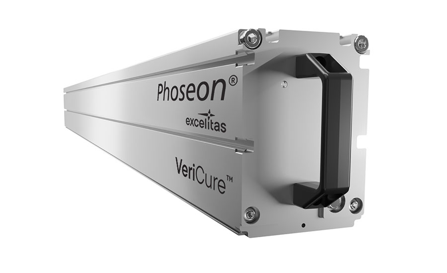

Excelitas Technologies' VeriCure UV LED curing system
Photo courtesy of Excelitas Technologies Corp.
UV Curing System for High-Speed Coating
VeriCure is a wide-format, water-cooled UV LED curing system for wood coating applications. It features a patented Semiconductor Light Matrix (SLM) array and a unique high-efficiency cooling system, delivering high optical power and energy for high-speed processing. SLM technology provides optimum uniformity across the irradiation area to ensure peak performance and consistent curing quality. With available wavelengths of 365, 395 and 405 nanometers, the VeriCure system offers versatile integration supported by a comprehensive suite of communication protocols.
The high-efficiency UV LED system consumes 60 percent less energy and reduces maintenance and consumable costs compared to conventional systems. An optional secondary glass assembly protects from volatilized compounds, minimizing downtime and repair costs.
The system does not require warm-up time and offers customizable output levels for better energy efficiency and longer LED lifetimes. The device supports conveyor speeds of up to 50 meters per minute.
