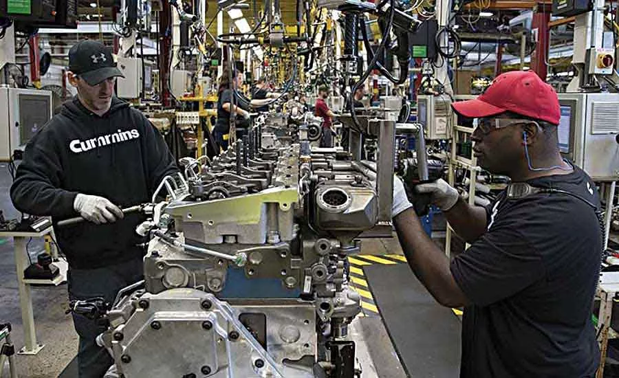

Ergonomics Software System Reduces Risk at Cummins
More than 230 Cummins Inc. facilities across the globe rely on the Humantech System to methodically assess worker ergonomics. Photo courtesy Cummins Inc.
