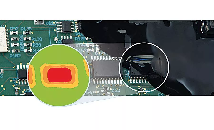

Whether it’s an automotive application or an electronics application, engineers are increasingly looking for adhesives that offer high performance at high temperatures. To meet this demand, the adhesives industry has developed a range of products that meet structural, sealing and encapsulation requirements even at temperatures in excess of 200 C.
Although heat-resistant adhesives can bond at high temperatures, it is important to remember that they are still not as strong at high temperatures as they are at room temperature. However, when used correctly, these adhesives will remain permanently stable and perform their function due to the close cross-linking of the polymers.

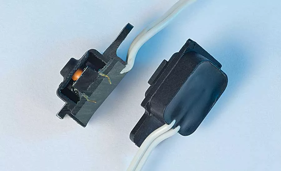

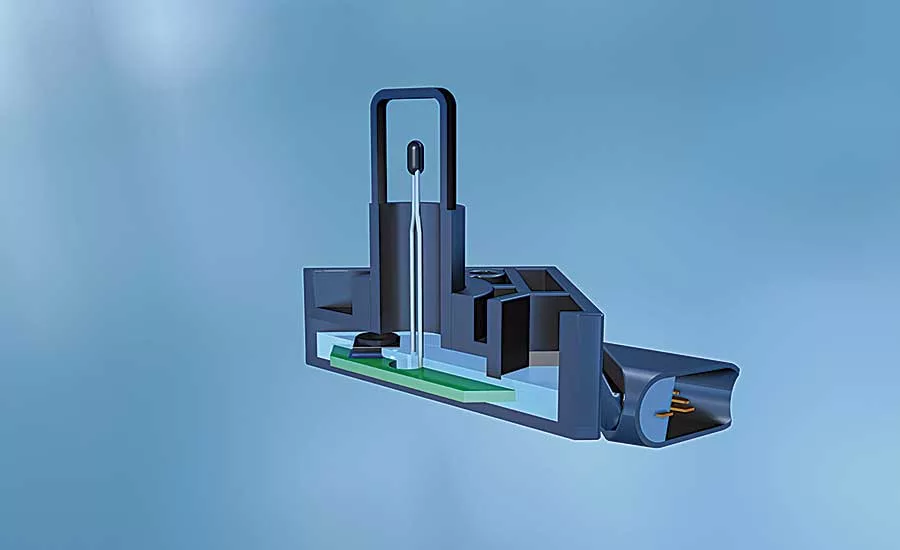

The need for heat-resistant adhesives exists in numerous industries. In the automotive industry, they are used in such applications as engine sensors and exhaust management systems, where they are also exposed to aggressive chemicals. Heat-resistant adhesives are also used to bond components in the engine bay, where temperature requirements are rising due to the introduction of a new cooling system. Because this new system is more powerful, it generates more heat and strongly affects other components in the engine bay.

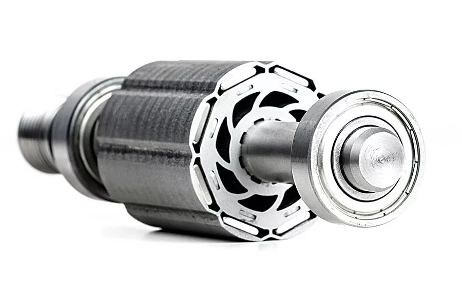

Heat-resistant adhesives are also seeing use in the manufacture of power tools. Electric motors are becoming more powerful and generating more heat. More compact motor designs also lead to increased levels of accumulated heat. Heat-resistant adhesives are essential to bond magnets or to fix the rotor to the shaft. For tools like angle grinders, adhesives are applied as a casting compound and are used to fix copper wires found in the rotors of the motors, which can become very hot. The adhesives protect the wires against damage by abrasion caused by airborne particles.
Heat-resistant adhesives are also found in power electronics. Machinery such as locomotives and oil-drilling equipment use so much power that electric components can reach temperatures of more than 200 C. Conversely, in the aviation sector, heat-resistant adhesives are seldom required because of ambient temperatures. When they are used, it is only in areas that are close to the engine, like the inlet, the fan blades or the front guide wheels.

Light-curing acrylates are deployed both as a sealant and as an adhesive. The most temperature-resistant products of this type are suitable for temperatures of up to 150 C.
Anaerobic curing adhesives, based on methacrylate, are appropriate for temperatures up to 200 C under normal requirements. If, for reasons of efficiency, a popular light-curing component is integrated, the threshold is 180 C.

For structural tasks, epoxy resins with amine curing agents are common. They resist impacts, which is an important characteristic for handling dynamic loads. That’s why these adhesives are often used to bond the surface magnets in electric motors.
