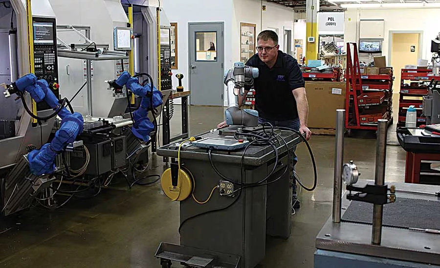

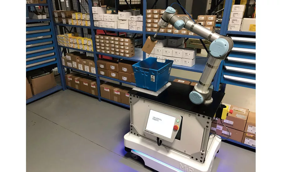

One company attracting attention at the Automate show was Universal Robots USA Inc. (UR). It displayed a UR5 arm attached to a MiR200 mobile platform from Mobile Industrial Robots Inc. (MiR).
“Mobility increases the reach and usability of robots,” says Craig Tomita, western area sales manager at UR. “Because they’re low-voltage, our collaborative robots can be powered by the battery already onboard a vehicle. Robots are no longer relegated to staying in front of one machine or one conveyor for their entire life.
“Mobility offers tremendous flexibility, especially for small manufacturers and contract manufacturers,” explains Tomita. “They can easily redeploy a robot as their needs change.”

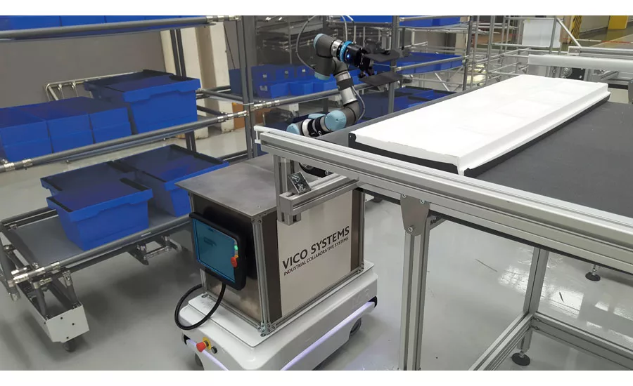

The MiR200 is an autonomous mobile robot (AMR), a new type of machine based on technologies that make it faster, smarter, easier to use and more efficient than traditional automated guided vehicles (AGVs).
“AMRs, and the industrial robots piggybacking on them, are individually both collaborative and super flexible,” says Ed Mullen, vice president of sales for the Americas at MiR. “When you place a robot onto an AMR, you get even more flexibility and a higher degree of automation.
“You can have the AMR drive wherever you want it to go via its intelligent navigation system,” adds Mullen. “That makes it able to autonomously drive to its targets. Then, you can have the robotic arm automatically pick something up. This increases efficiency. Since employees don’t need to be involved in this process, you free up resources.
“[Engineers should] consider the AMR as the legs, the piggybacking robot as the arms and software as the brain,” Mullen points out. “This opens the complete solution up for many applications.”

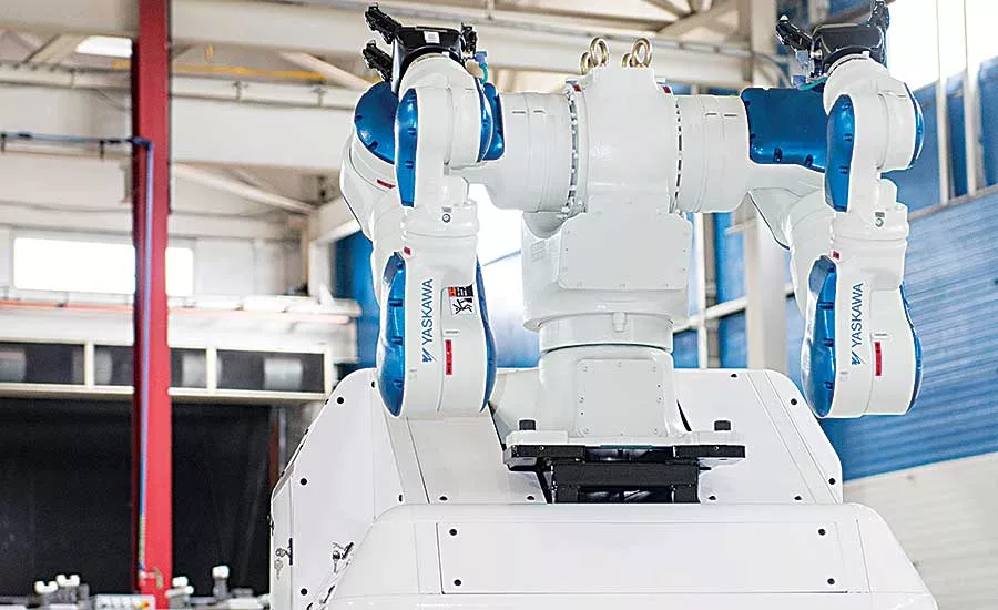

According to Keith Vozel, software product manager at the Motoman Robotics Div. of Yaskawa America Inc., there are three distinct types of mobile robots:
  • Devices that can manually be moved as needed.
  • Autonomous robots that can deliver parts and materials throughout a factory.
  • Fully functional robotic manipulators or autonomous industrial mobile manipulators that move through a plant, essentially taking the robot to the work vs. bringing the work to the robot.

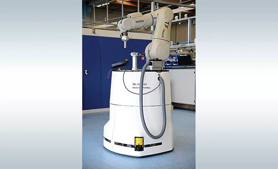

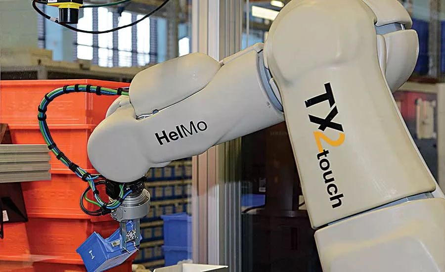

Engineers at Stäubli Robotics Corp. recently developed a mobile machine called the HelMO. The robot is currently in use at the company’s factory in Bayreuth, Germany. It’s used to assemble electrical connectors for coupling systems.
“Unlike other mobile robotic applications that involve piggybacking, HelMo can drive and navigate autonomously,” says Sebastien Schmitt, robotics division manager at Stäubli. “It continuously monitors its environment using three integrated laser scanners. The robot system can either perform tasks fully automatically at high speed, or collaborate with humans if necessary.”
The mobile robot navigates independently to its workplace, reduces its speed or stops when humans come too close, then sets off again.
HelMo is based on a six-axis TX2 collaborative robot, which boasts a maximum payload capacity of 15 kilograms and a range of 1,200 millimeters. A touch-sensitive surface stops movements immediately in the event of direct contact with humans.
“Among the various tasks assigned to the system, the complex assembly work requires a high degree of precision,” says Schmitt. “The robot positions itself precisely to within a tenth of a millimeter, calibrating its position via three measuring points permanently installed at the workstation.
“HelMo is the first [mobile] industrial robot for assembly applications,” claims Schmitt. “The basic idea was to use one industrial robot on different applications and different workplaces. To [create] not only an industrial robot on an AGV system, our aim was to develop a complete mobile robotic unit consisting of different tools and safety features.
“The main benefit of the mobile robotic system is flexibility,” adds Schmitt. “The robot can be used for pick-and-place applications, logistics and material handling. And, it can be easily integrated into existing production environments. The machine does not need any guidance, such as reflectors, wires or magnetic stripes.”

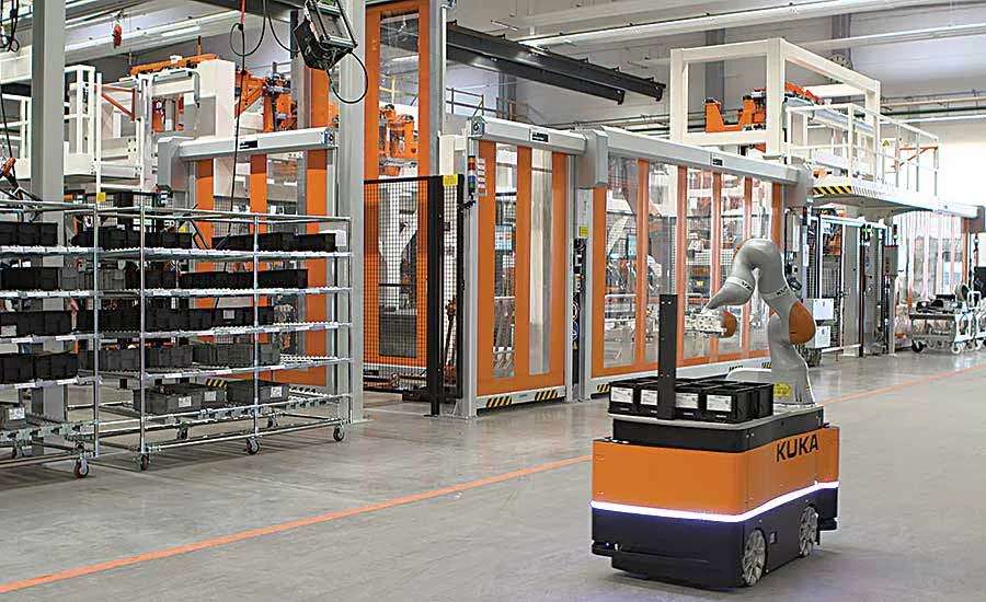

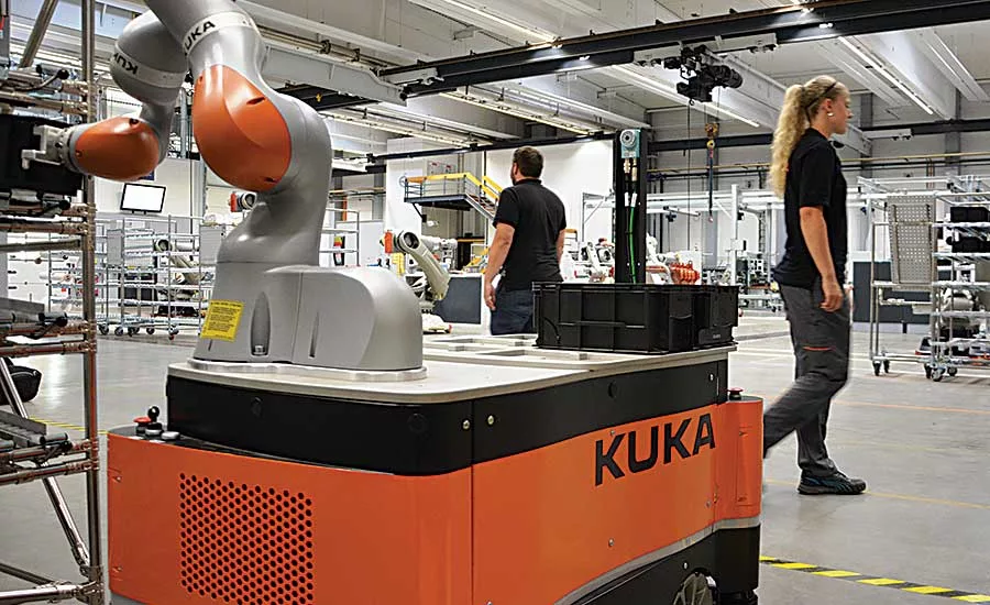

Another company at the forefront of the mobility revolution is KUKA Robotics Corp. In fact, it has been developing the technology for more than 10 years.
KUKA Robotics Corp. has been developing mobile robot technology for more than 10 years. The first commercial product it launched a few years ago was omniMove, a modular platform for transporting heavy loads in tight spaces. The eight-wheeled device boasts unrestricted mobility. It’s already in use at manufacturers such as Airbus and Siemens.
Each wheel can move independently of the others. They consist of individual, barrel-shaped rollers encapsulated by two fixed rims that don’t touch the ground. As a result, the machine can maneuver sideways, diagonally or in a circle. A KUKA KR Quantec series six-axis robot can be mounted onto the platform.
 “The omniMove laid the foundation for future mobile robotic concepts,” says Denise Ebenhoech, regional head of advanced robotic applications at KUKA Robotics. “Today, omniMove platforms are widely used, handling payloads from 3 tons up to almost 100 tons.
“The omnidirectional wheel technology allows very precise movements in all directions, which reduces floor space,” Ebenhoech points out. “The main application is the transportation of large, heavy parts like those found in the aerospace industry.
“Alongside the work on the omniMove platforms, we also began researching flexible and safe navigation concepts for mobile robots,” adds Ebenhoech. “This led to the development of our KUKA Navigation Software, which can be used with all the mobile products.”
The software uses laser scanner data to create a 2D map of the environment, similar to a street map. Using this map, a mobile robot can localize itself, navigate and operate safely.
“There is no need for additional markers, reflectors or other fixed devices, allowing the mobile platform to be easily integrated into existing production layouts,” claims Ebenhoech. “The system can operate where there are other moving obstacles, vital for use in real production environments, where pallets or carts [are] being loaded or unloaded.”
The navigation research team worked closely with the engineers responsible for the development of KUKA’s first collaborative robot, the LBR iiwa.
“Lightweight and safe, this robot was the perfect choice to mount on an autonomous mobile platform, enabling the next technology step: the mobile robot,” says Ebenhoech. “The KMR iiwa is the result of combining all the best available technologies.”
Prototype versions of the KMR iiwa are already installed and running at several different manufacturing sites. Commercial production of the machine recently began and some manufacturers are in the process of integrating the technology into their production lines.
“Additionally, we offer the KUKA flexFELLOW, a location-independent robot unit for the LBR iiwa that can be moved by hand to wherever automation is needed,” explains Ebenhoech. “It serves as both the electrical cabinet for the controller and offers space for the integration of customer-specific components, as well as various media connections.”

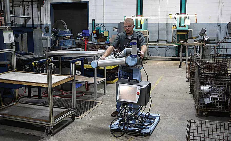

“That type of manual mobility is the most prevalent use of our robots,” says UR’s Tomita. “In fact, one of our customers actually calls their robot Waldo, because it’s used in locations all around the plant.”
Scott Fetzer Electrical Group (SFEG), a division of Scott Fetzer Co. that produces small motors, recently turned to mobile robots to improve productivity at its high-mix, low-volume assembly plant in Fairview, TN.
“Most of our assembly lines don’t run all the time, so trying to find a way to put robots on the line in the traditional sense was a big challenge,” says Matthew Bush, director of operations at SFEG. “We wanted to build a mobile, flexible robot force.”
Bush and his colleagues placed UR5 and UR10 robots on pedestals with wheels that enable them to deploy the machines throughout the factory for various applications. For instance, one machine cuts 16,000 wires daily—a job that used to be performed manually. Another robot is wheeled into place to fill epoxy into circuit boards.
“We want to  have robots standing by, waiting for a job to do,” explains Bush. “When the staff arrives in the morning, we have work orders printed for employees to wheel the robots over to the tasks at hand that day.”
