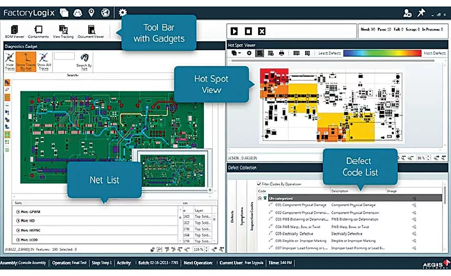

Connor also upgraded its manufacturing execution system (MES) to FactoryLogix made by Aegis Software. Craig Bryant, quality and engineering director at Connor, says that the FactoryLogix suite was primarily selected because of its compatibility with all machines in the plant.
FactoryLogix consists of five modules—new product introduction, production, quality, integration and analytics—that enable Connor to seamlessly streamline all of its manufacturing operations, and stay on its schedule for planned growth. The software also easily integrates with the company’s Fuji Aimex surface mount technology (SMT) equipment, Koh Young automated optical inspection system and multiple test platforms.
“This investment provides a powerful platform for new product introduction, traceability, seamless integration to ERP, and in-circuit and functional testing,” explains Bryant. “Also, for key manufacturing processes, it enables real time monitoring, automated analytics and reporting, including first-time pass rates and hot-spot defect analysis.”
FactoryLogix monitors all aspects of Connor’s production, including three SMT lines, a through-hole technology area, conformal coating application and final assembly. The software also tracks in-circuit and functional testing, as well as automated inspection.
According to Bryant, the software increases part traceability. For example, each PCB is laser-etched with a unique bar code for quick identification. No production operation can begin until an operator has signed off the previous process by scanning a bar code. This is particularly valuable to Connor, which offers traceability down to the component level to meet aerospace requirements. FactoryLogix also facilitates more efficient production routing, and allows quick and easy changes by its operators.
With the new product introduction module, engineers define the assembly process, not the physical route. This approach allows them to apply the process across production lines where station counts vary and operations may be performed by a human or a machine. Equally important, each process is easily added to the assembly’s process definition for one or more serialized units.
The software’s production module delivers paperless and process verification through a user-configurable interface. Interactive visual documentation is automatically dispatched to each workstation where and when it is needed.
