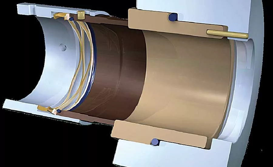

Multi-turn wave springs are often used in mechanical seal applications, as well as in power transmission and fluid power systems. Graphic courtesy Rotor Clip Co. Inc.

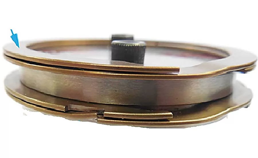

A circular fastener, the retaining ring (arrow) is installed in a groove to hold components on a shaft or inside a bore. Photo courtesy Rotor Clip Co. Inc.

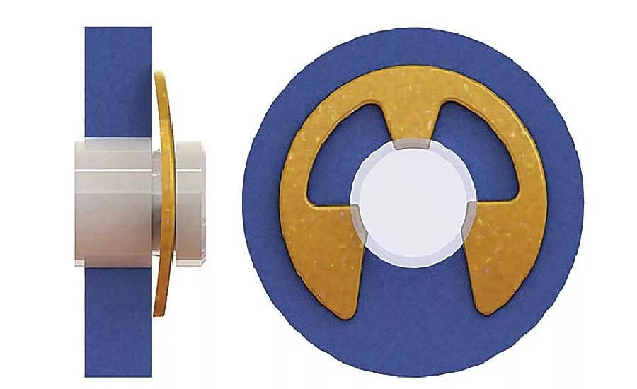

Some retaining rings, like this bowed E-ring, combine the features of radial installation with end-play take-up. Graphic courtesy Rotor Clip Co. Inc.

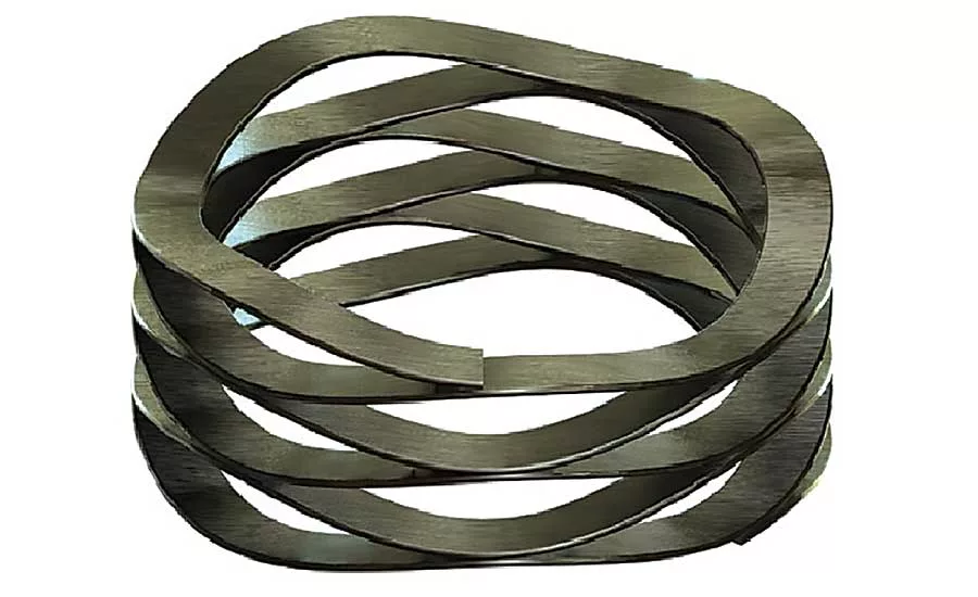

A variation of the retaining ring is the wave spring, which is a spiral ring with an axial wave form. It comes in single- and multi-turn (shown) versions, and is made from flat wire. Graphic courtesy Rotor Clip Co. Inc.

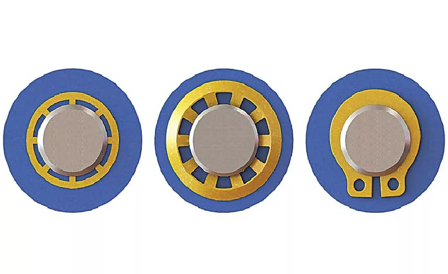

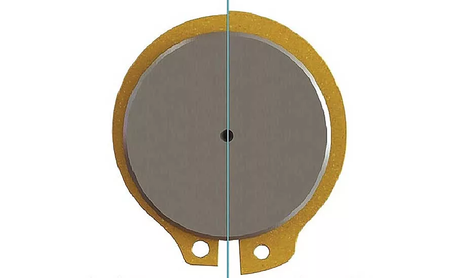

Radially installed rings also vary. The crescent C-ring is preferred where space is at a premium and loads are not very heavy. This type of ring is also more tamper resistant.
The E-ring, which is a C-ring with notches on each side of a bottom center piece, is ideal for large shoulders. A reinforced E-ring is best for applications characterized by high vibration, speed and cyclic loads.
The reinforced ring is interchangeable with the E-ring but grips the groove bottom with 3 to 5 times more radial force and has greater resistance to fatigue failure. In most cases, its outside diameter or shoulder is larger than the E-ring’s, which is another factor to consider. All three styles are available in taped cartridges for assembly with dispensers and applicators.

Some retaining rings combine the features of radial installation with end-play take-up. For example, a basic E-ring can be bowed over its horizontal axis and pushed into the groove from the side of the shaft. This will exert axial pressure against the retained part.

A variation of the retaining ring is the wave spring, which is a spiral ring with an axial wave form. It comes in single- and multi-turn versions, and is made from flat wire.
Single-turn springs often take the place of stamped wave washers. Applications include bearing preload, connector and fluid power seals, as well as noise and vibration attenuation. Multi-turn wave springs usually replace coiled springs or stacks of disc springs, and are used in mechanical seals, and power transmission and fluid power systems.
The main advantages of wave springs is their excellent force-to-work height ratio. Well-designed wave springs can produce the same or even greater forces
as coiled springs, whose work heights are up to twice as tall.
Wave springs produce a consistent force across a wide range of deflections, and their deflection curves have a wider, flatter linear force region than either coiled or disc springs. Also, because wave springs transmit spring forces only in the intended axial direction, they don’t suffer from the torsional loading and twisting that can make conventional coil springs less effective.

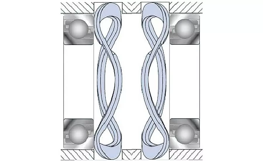

Enormous axial loads regularly cause wind-turbine gearbox bearings to move in multiple directions. This results in bearing race wear and metal debris that leads to bearing failure. Retaining rings can be used to secure the bearings and prevent all other rotational movement within the gearbox.
A common reason for bearing movement is their being relatively loose in the bore. This situation guarantees easy assembly of large components typically used for wind turbines and balances possible thermal radial expansion during gearbox operation. But, it also allows rotational movements of the bearing because there isn’t sufficient friction between the outer race of the bearing and housing surface. As a result, the retaining ring’s axial contact with the bearing causes rotational movement of the ring, resulting in failure.
Another type of movement is a rotating gear and ring. Because the axial friction between the gear wheel and ring is greater than the radial load of the ring and the friction between it and the groove, the ring rotates.
Rotational movement may also be caused by high dynamic torsional loads in an axial direction. When components in a turbine gearbox are fixed by a retaining ring, and dynamic axial loads are introduced, the ring rotates in the groove. This is not caused by the rotation of a retained component, but by the loads exerted on the ring.
Fortunately, each of these movement challenges can be solve with the right retaining ring; thereby increasing bearing life and improving turbine performance.
A single-turn wave spring with a specific axial load is recommended for loose-fitting bearings. The wave spring generates a precise load to guarantee nondestructive levels of force. This action, in turn, hinders the tendencies of the outer race and the retaining ring to rotate.
Single- or two-turn wave retaining rings are an alternative solution. Combining a standard retaining ring with a wave spring, they retain and pre-load the outer race of the bearing.
