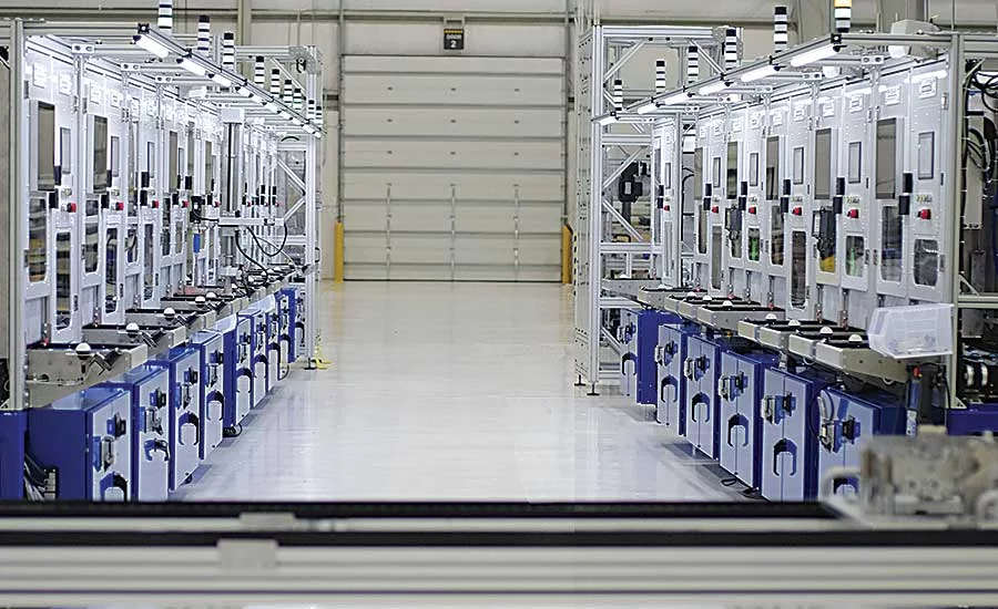

Kinemetrix designed and built an agile, multistation automated assembly system to produce inverter modules for a hybrid vehicle.

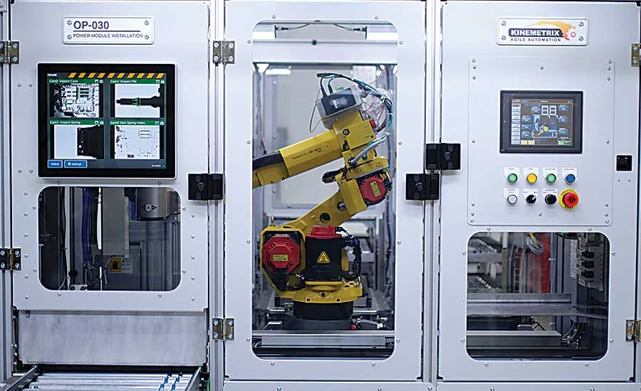

The assembly system is equipped with 22 robots in 17 standardized process modules.

Recently, Kinemetrix designed and built an agile, multistation automated assembly system to produce inverter modules for the hybrid variant of one of the largest vehicle programs in the world. An inverter module converts DC voltage from battery storage into multiphase power for driving a traction motor.
The system consists of a series of standardized process modules. Each module is pallet-based, with its own independent transfer conveyor.
“Keeping each module independent is an investment that pays off by maintaining flexibility to reconfigure the line for changes in product design, mix or volume—all three of which occurred between when the project kicked off and when it shipped,” explains Jim Peyton, the founder and president of Kinemetrix.
The system operates in a Class 10,000 clean room and produces an inverter every 120 seconds. Protections against electrostatic discharge (ESD) are included throughout the assembly process.
The inverter is 360 millimeters wide, 250 millimeters long and 120 millimeters tall. The assembly process brings together 24 components using 49 fasteners and a variety of adhesive processes. Approximately 50 precision TIG welds make the high-power electrical connections.
 The assembly comprises cast, stamped, formed and machined metals; plastics; printed circuit boards; small wiring harnesses; film and foam insulators. Many of these parts are precise and electrically or mechanically sensitive. Components are fed into assembly modules via magazine trays that nest parts to prevent damage. Magazine trays can be loaded lineside by a single operator. (In the future, Kinemetrix will provide a system of automated guided vehicles to tend the line, or multiple lines, directly from upstream subassembly processes.)
The assembly system is equipped with 22 robots in 17 standardized process modules. Processes include:
  • Robotic micro-TIG welding with 3D vision guidance and weld inspection.
  • Robotic dispensing of a form-in-place gasket.
  • Precision leak testing.
  • Robotic pick-and-place and automated screwdriving.
  • Potting with a two-component epoxy.
  • Manual operation stations for wire harness assembly.
  • Convection curing and cooling.
The assembly system has 28 vision-based inspections, 30 code readers, and two Agile3D Copperweld robot guidance and weld inspection systems. The vision inspections use conventional and computational imaging to ensure pre-assembly conditions are within standard. All robotic assembly and screwdriving tasks are vision-guided to minimize tolerance stacking effects. Each automated and manual assembly process is validated before being transferred to the next step.
