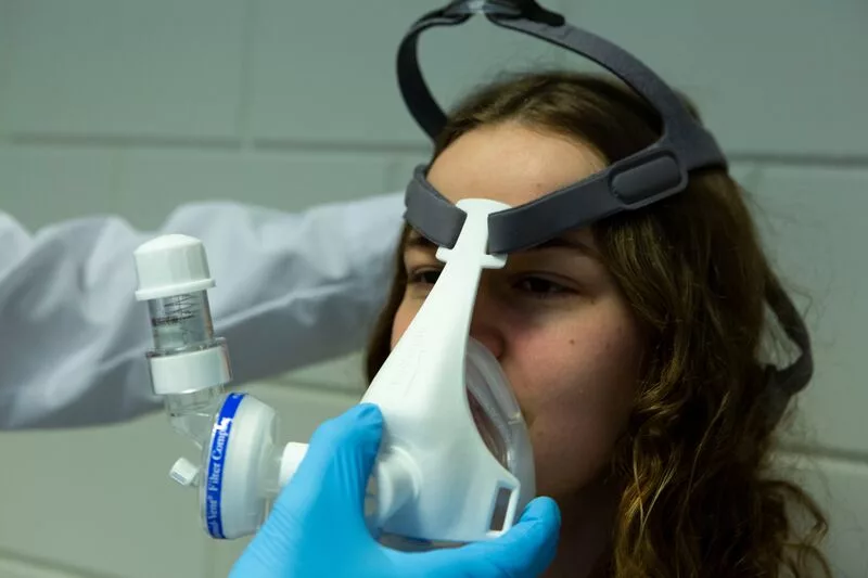

LEUVEN, Belgium — Materialise, a Belgium-based pioneer in 3D printing, has developed the Materialise NIP Connector, a device to convert standard equipment into a mask to facilitate breathing for patients by creating positive pressure in the lungs.
These assembled masks allow clinicians to reduce the time patients need access to mechanical ventilators, which helps to reduce the strain on ventilator supplies. Materialise has decades of experience in certified medical 3D printing and is now fast-tracking the regulatory registrations that are crucial to ensure the safety of patients and caregivers. The company expects to have the device broadly available for hospitals by mid-April.
Around the world, hospitals are looking for medical equipment capable of delivering air with added oxygen to treat critically ill coronavirus patients. Currently this treatment is carried out using mechanical ventilators, which are critically under-supplied. As a result, clinicians today are exploring different methods to apply positive end expiratory pressure (PEEP) to the lungs of COVID-19 patients without the use of a ventilator.
The solution delivers oxygen and creates high positive pressure without the use of a ventilator. A 3D printed connector converts standard equipment already available in most hospitals into a non-invasive PEEP mask (NIP) that can be connected to the oxygen supply (to facilitate breathing for coronavirus patients). It gives patients an extended period of time before mechanical ventilators are required for treatment and helps transition them off ventilators earlier, freeing up these devices for patients in critical need. By using standard medical equipment, including a non-invasive ventilation (NIV) mask, a filter and a PEEP valve, the solution is simple and familiar to use for medical professionals.
Materialise is now fast-tracking the regulatory registration in Europe and the U.S. Additionally, Materialise is supporting a clinical trial to test the clinical impact of its use on COVID-19 patients and expects first results to be available within the next two weeks.
