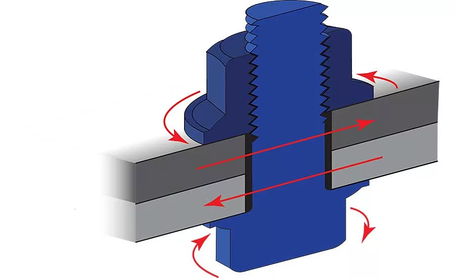

Self-loosening is the process in which the external and internal threads rotate counterclockwise relative to each other due to external loading. This type of loosening is usually triggered by repeated slipping of the joint due to reversing shear loads. In extreme cases, it is possible for the bolt to self-loosen completely, and for the bolt to fall out altogether.

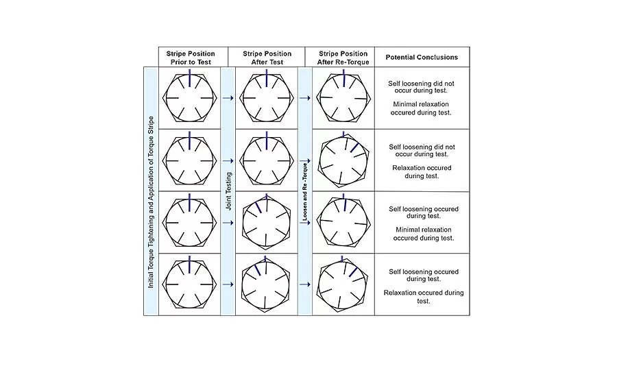

Many companies require assemblers to mark the head of the bolt or the nut with a paint stripe, otherwise known as a torque strip or witness mark, to attest that the bolt was tightened to the proper torque value. This technique is a valuable quality assurance step, but what is not widely known is that torque stripes can also be used to detect the type of bolt loosening that occurred during a test—if the paint stripe is extended to include the joint.
Self-loosening can easily be detected after the test by looking for evidence that there was relative counterclockwise movement between the internal and external threads (see table).
A qualitative measurement of relaxation in the bolted joint can also be made using torque stripes, if the bolt is retightened to the original torque value after the test. If the torque stripe shows relative clockwise movement between the internal and external threads after retightening, it is likely relaxation occurred during the test.

The following simple test procedure can be used to identify self-loosening and relaxation in a bolted joint.
  1. Prior to assembling, lubricate the threads and the rotating, load-bearing surfaces of the nut and bolt.
  2. Assemble and tighten the nut and bolt to the recommended (lubricated) torque value using a calibrated torque wrench.
  3. Using a paint marker, apply the torque stripe to each nut or bolt. The stripe should extend from the nut or bolt head, over the washer and to the joint.
  4. Test the joint for loosening in simulated or actual service conditions.
  5. Observe and record the angle of relative counterclockwise movement between the internal and external threads.
  6. Loosen the nut or bolt approximately 30 degrees and retighten the fastener to the same torque value used in step 2, using a calibrated torque wrench.
  7. Observe and record the angle of relative clockwise movement between the internal and external threads.
  8. The type of loosening which occurred during the test can be determined using the table.
Understanding whether a bolt loosened due to self-loosening, relaxation or a combination of both is critical for making the right design changes or choosing the best thread locking method. Fortunately, a simple torque stripe can used to detect the type of bolt loosening that occurred.
