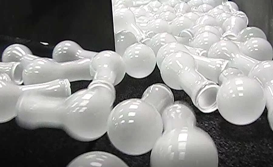

To gently and efficiently feed glass bulbs of various shapes and sizes in an automated assembly system, one lighting manufacturer is using Dyna-Slide linear conveyors from the CDS LIPE Division of Contract Design Service Inc. in Liverpool, NY.
Dyna-Slide linear conveyors operate without belts, pulleys, rollers, chains, sprockets or other moving parts that can jam and clog. This means fewer breakdowns, increased reliability, less maintenance and greater operator safety.
The device consists of an aluminum conveyor bed lined with a special brush material. It uses a variable-speed vibrator to provide a gentle flow of parts. The brush bristles are angled, so they push the parts forward and slide back under them as the bed is rapidly vibrated, giving a finger like action to the conveyor bed.

For the lightbulb assembly application, the conveyor feeds the bulbs in a hanging orientation with the open end of the bulb down at a rate of 60 parts per minute with no breakage.
“The biggest challenge was feeding the lightbulbs without breaking them,” says Frank W. Scarson III, president of CDS LIPE. “Dyna-Slide linear parts feeders are well known for their gentle handling, adjustability, and return on investment because they can be configured for a wide range of parts.”
