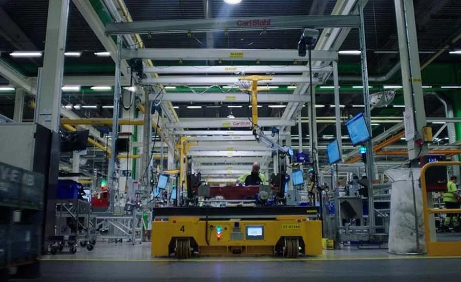

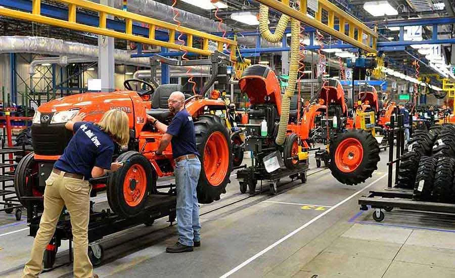

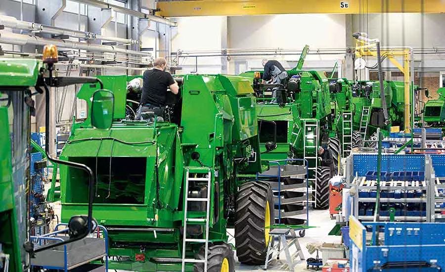

One equipment manufacturer that has benefitted from automation is Kubota Manufacturing of America Corp. (KMA), which operates several factories in Georgia.
“We’ve purchased many different brands of AGVs in recent years and we’re currently using about 160 machines for material handling applications, including just-in-time parts delivery,” says Brian Arnold, vice president of operations at KMA. “However, some of the devices are built in-house by our manufacturing engineering department.
“We’ve developed lost-cost technology that enables us to deploy AGVs in many types of applications,” explains Arnold. “We typically purchase the drive kits, then integrate things such as the frame structure and safety controls to meet our unique needs.
“Some of our sister plants in Japan are very automated, especially the engine assembly facilities,” adds Arnold. “But, our U.S. tractor factories rely heavily on manual processes. Everything we produce is built to order, so the volume and diversity of our product line just doesn’t lend itself to fully automated systems.”

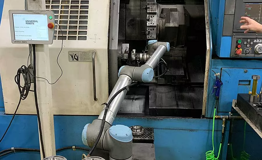

CNH Industrial Sees Big Role for Cobots
CNH Industrial is a leading producer of agricultural and construction equipment, with popular brands such as CaseIH, New Holland and Steyr. The company is also at the forefront of applying automation and Industry 4.0 technology. In fact, it’s in the midst of implementing a global smart factory initiative that is focused on deploying state-of-the-art AGVs and collaborative robots.
“We want to minimize the risk to workers and also improve their physical well being,” says Peter Ommeslag, head of Industry 4.0 at CNH Industrial. “Cobots and AGVs reduce the potential for accidents, while also decreasing the physicality of day-to-day work.
“Efficiency is the main focus of our activity,” explains Ommeslag. “But, we also consider other aspects to make jobs even easier and to change the way we go about manufacturing, by introducing new technologies, a new culture and new skills into our production lines.
“We’ve found that cobots substantially minimize the previous difficulties our staff endured,” claims Ommeslag. “They can be used by employees with disabilities and those using wheelchairs, which is great.
“With aging workforces becoming more common, cobots will allow people to work longer and more safely,” Ommeslag point out. “They are a very intuitive technology, so people don’t need extra training. As the technology continues to evolve, cobots have huge potential for learning new skills in the future.”

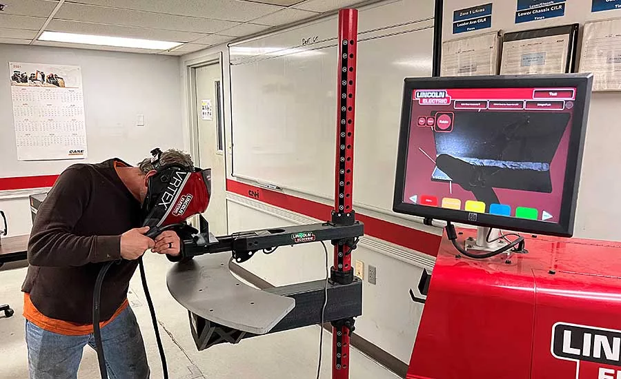

In particular, CNH Industrial has harnessed virtual reality technology to train welders. In addition to teaching both new hires and veteran welders alike in a safe environment, costs are reduced because parts and materials aren’t scrapped or wasted.

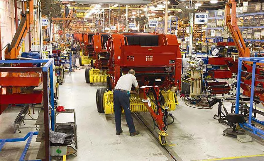

  • The New Holland, PA, factory that produces implements such as balers, mowers, rakes and spreaders piloted a project involving assembly line cobots.
  • The tractor plant in Racine, WI, uses AGVs to transport transmissions from subassembly lines to the final assembly line.
