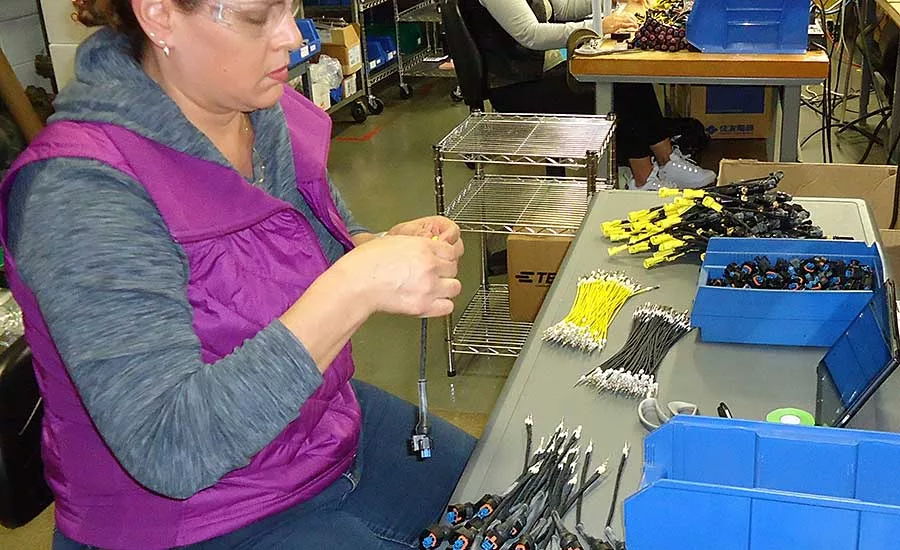

Fifty-six people work at CEL’s Elmhurst, IL, facility, with half in assembly and production. Photo by Jim Camillo
