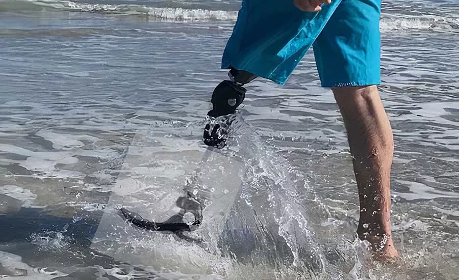

Fasteners Assemble Prosthetic Joints
The Niagara Foot is an affordable, high-performance prosthetic foot designed for individuals with active lifestyles. The All-Terrain Knee is a mechanical prosthetic knee joint for people with above-knee amputations. Both prosthetics can be used in aquatic environments, since they purely work mechanically. However, this requires that all components are resistant to saltwater, including the screws.

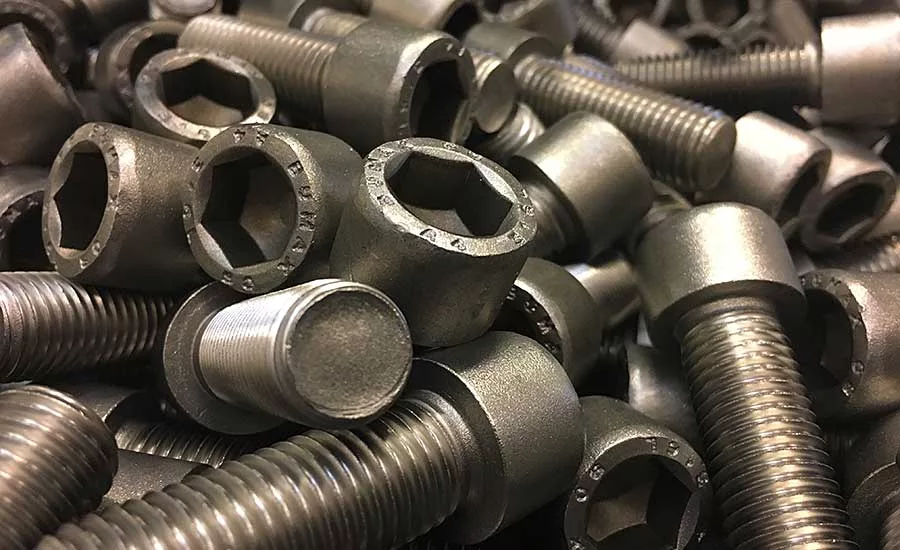

“We tried a variety of stainless steel screws when developing the waterproof knee joint, but the BUMAX SDX 109 was the only screw that provided both the strength and corrosion resistance we required,” explains Jochen Weigel, co-owner of DOI ortho-innovativ.
Super duplex stainless steel fasteners are unique because they combine super high-strength with excellent corrosion resistance compared with alloy steel fasteners. They have two-phase microstructures containing ferrite and austenite and are cold-headed and thread-rolled.
“The SDX 109 is from our high-strength super duplex fastener range. It provides excellent mechanical properties and exceptional resistance to general crevice, pitting and stress corrosion,” says Klaus Vogt, business development manager at BUMAX. “Due to their high levels of chromium and molybdenum, super duplex grades provide even greater corrosion resistance than duplex grades.”

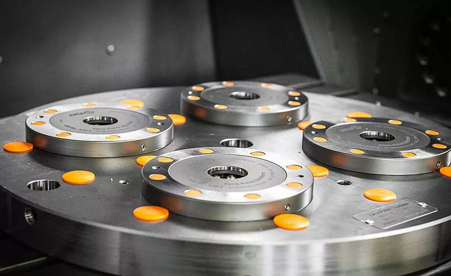

Strong Clamping
For examples, BUMAX 109 screws are a key component of the Zero-Point clamping systems produced by Andreas Maier GmbH & Co. Based in Fellbach, Germany, Andreas Maier makes work-holding products for machine tools. The company’s clamping modules are used in milling processes and turning centers to enable fixture and workpiece changes within seconds.
Andreas Maier previously used carbon steel screws (class 10.9 and 12.9) with corrosion protection for its Zero-Point products. However, the company required a more durable fastener.
“Our Zero-Point clamping systems require a maximum stiffness, strength and vibration tolerance, so we were looking for a fastener that would outperform normal stainless steel,” explains Christina Holm, product manager for Zero-Point systems. “BUMAX screws were the only fastener that fully met all of our tensile tests for extreme loading scenarios.”
BUMAX 109 and BUMAX 109 Ultra screws are now used to secure the modules, providing extremely high holding forces. (BUMAX 109 Ultra is used for some screws because a particular head cap can only be manufactured in BUMAX Ultra steel.) Despite the forces and vibration associated with machining processes, the fasteners prevent any movement or lifting off of the support flange of the clamping modules.
“An example is our K20 Clamping Module, which generates a pull-in and locking force of up to 20 kilonewtons and a holding force of 55 kilonewtons,” says Holm. “BUMAX 109 Ultra screws are stable against static and dynamic forces during the machining process, even under extreme forces.
“Importantly, BUMAX screws are also available in a range of sizes, which makes them suitable for all our zero-Point clamping modules, including pneumatic, hydraulic and automation modules,” she continues. “High-strength and vibration-tolerant BUMAX screws ensure our customers benefit from components with the highest level of quality, accuracy and operational safety.”
