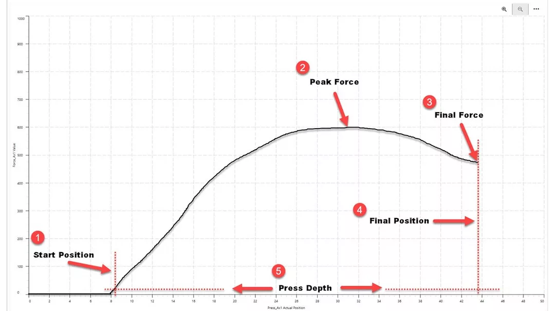

Any application involving press-force and positioning benefits greatly from in-process monitoring and gauging, which ensures that the products have been assembled properly in order that they will function properly in the hands of your customers. Effectively evaluating the generated press-fit curve is key.

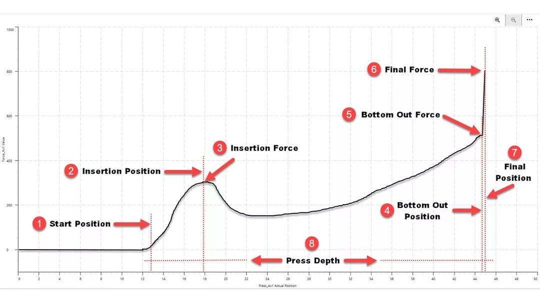

Firstly, the characteristics of the data curve of a good component must be determined. This can be calculated theoretically by the engineers involved, and adjusted as more data becomes available. Another option for determining the data curve of a good component is with the use of a master, or known-good, component, which is used to generate an ideal data curve against which future components are gauged. In the absence of a master component, an ideal curve can be generated by running several acceptable components and using their data to calculate averages, as well as acceptable highs and lows.
The software, such as that which is part of every Promess system, is used to set up maximum and minimum limits and evaluate all future-generated curves against the ideal. If the curve is outside these limits, the software catches the issues and user receives a “NOK” on the component. The user can make adjustments to correct the issue.
In many automotive applications, simply pressing to a hard stop is sufficient. These applications include pressing in bushings & bearings, pressing on and seating clips and other fasteners, as well as countless others.
In many automotive applications, and especially in medical applications, where the stakes can be higher and where there are added levels of regulation, as well as requirements for verification data and traceability, simply pressing to a hard stop is not an option. In many instances, pressing to a position, whether absolute or relative, is required.

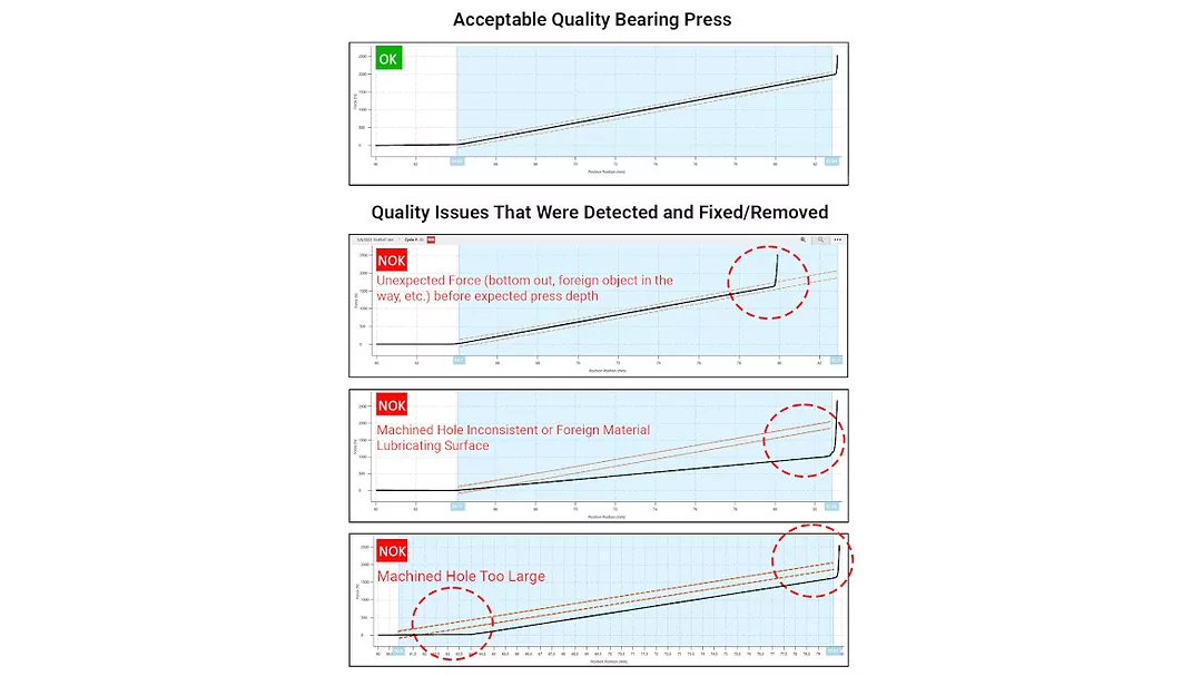

One manufacturer who was pressing bearings into pre-machined holes was experiencing incoming quality issues. The pre-machined holes, which came from one of their vendors, had a lot of variation. Some of the poorly assembled components were not caught before being shipped out to their customers, resulting in recalls, damage to their reputation, and tremendous expense.
Upgrading their system to one capable of effectively evaluating their press fit curve solved the problem by verifying quality in-station, while the suspect assemblies could still be fixed or removed, before they caused further headaches down the line, and long before they caused problems for the customer or end-user.
In the instance of the Bearing Press, and in countless other applications, simply using a press system capable of in-process monitoring & gauging solved the problem, not only of evaluating press-fit, but more importantly, kept bad assemblies away from customers, saving the manufacturer their reputation, as well as a whole lot of unnecessary expense.
