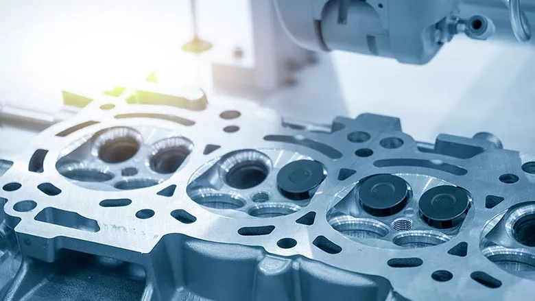

press-fit assembly
Photo: Phuchit / iStock / Getty Images Plus
