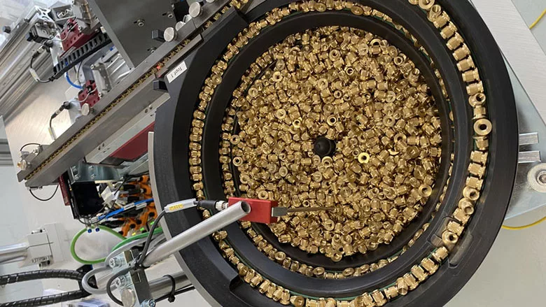

vibratory feeder bowl
Threaded bushings are supplied by a vibratory feeder bowl with an interior spiral track. Photo courtesy Afag Automation

The battery supports are produced in both left- and right-facing variants. The Afag system loads four components into the molds. Two of the components—threaded bushings and bolts—are supplied by classic vibratory feeder bowls with interior spiral tracks. The other two components are support plates, which are fed by vertical magazines that are similar to the playing card shoes used by blackjack dealers. Each magazine can hold 120 plates. One supplies the left plates; the other feeds the right ones.
