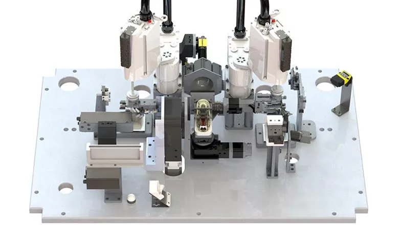

We started the prototype design with a desire to reapply as much as possible from the proof of concept, including hardware and design, to save the customer time and expense.
To create the prototype design, we calculated the physical layout of the system so that the robots could reach all areas with as small of a footprint as possible. We then engaged our mechanical partner to create a 3D concept for the system.
Flow chart of steps in building an automated assembly line
To create the first prototype system, engineers used advanced software to simulate the robotic movements in the assembly cycle. Photo courtesy Automation Nth
In parallel, we used advanced software to simulate the robotic movements in the assembly cycle, creating a “digital twin” of the prototype. Our digital modelling efforts ensured that the robots could reach all their points efficiently before we committed to any metal fabrication. The digital twin also helped us learn that we needed to move robots and stations in the physical layout to optimize motion efficiency. Our thorough pre-fabrication modelling ultimately saved the customer time and money with less rework.
After simulations confirmed that our physical layout was feasible, we authorized our mechanical partner to start building the prototype.

After accepting our prototype system and validating that risks had been mitigated, the customer was ready to move to a small-scale production system. Once again, Automation Nth created a digital twin to rapidly design the system, improve the physical layout to ensure that robots could reach every position, and optimize the process. The digital twin helped us develop a better design and reduce time spent debugging the system by a few months, saving the customer large amounts of money and time.
