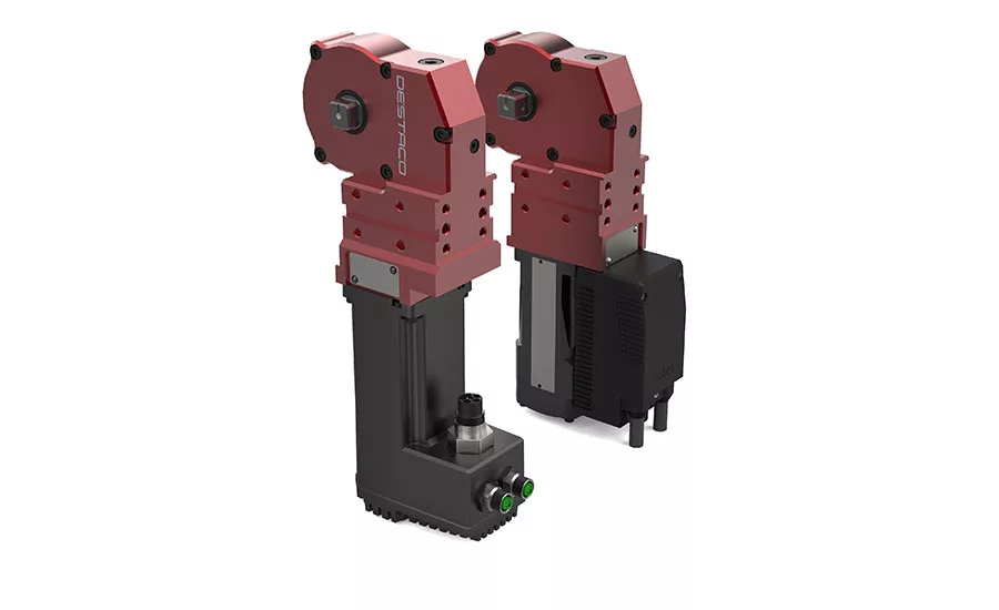

All-Electric Clamping System
Other new products include rack-and-pinion drives and durable linear actuators.
Image courtesy of DESTACO
May 31, 2024
Operating completely without compressed air, the 92W power clamps are energy-efficient and environmentally friendly. They reduce energy costs by up to 85 percent compared with pneumatic clamps. Integrated intelligence reduces the need for additional components, such as external sensors, and it provides essential data for process optimization. Operating data enables engineers to conveniently adjust the speed, positioning and torque to fine-tune production. Data can also be used to analyze process quality.
Control of the clamps is decentralized and attached directly to the production devices, which reduces cable lengths and cabling costs. This frees up space and ensures seamless integration of the clamps into production systems. Integrated tolerance compensation facilitates production of different components.
