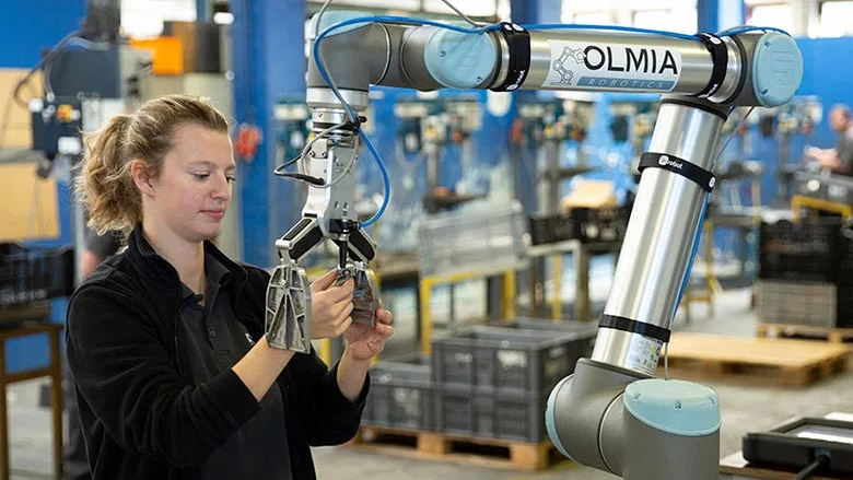

employee mounts finger to gripper
To handle individual parts, Donk has developed special fingers that employees can mount to the gripper in just a few minutes. Photo courtesy OnRobot

The fingertips of the RG6 can be replaced within minutes. All the employees have to do is loosen a few screws, attach the new fingertips, and retighten the screws. This enables them to quickly adjust the gripper to handle different parts. If new parts are added, the employees develop suitable fingertips together with Olmia Robotics. This flexibility is reflected in time savings and better delivery reliability.
